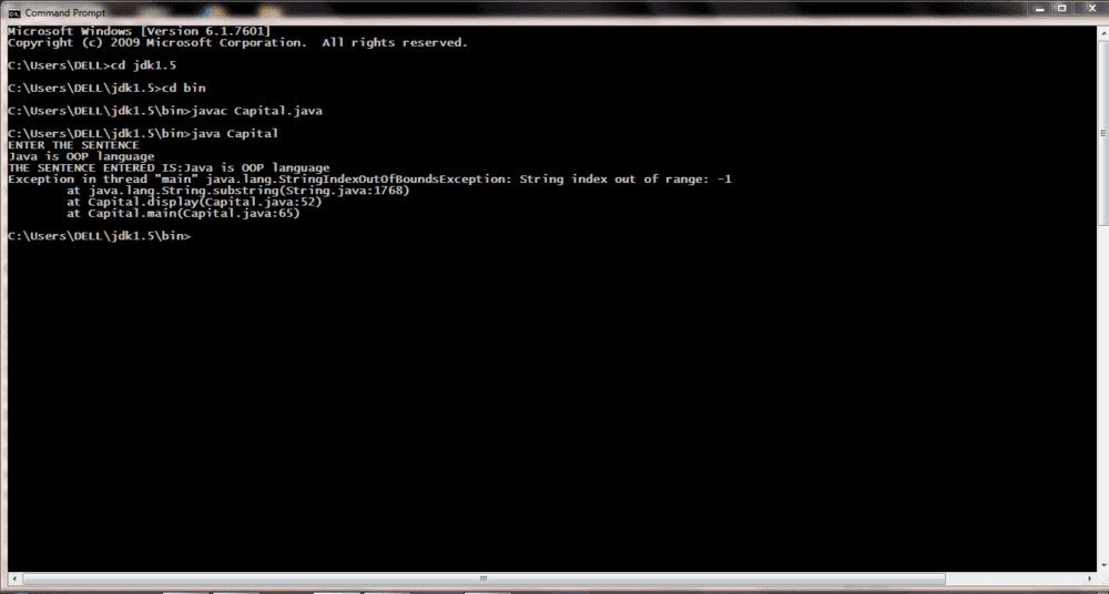

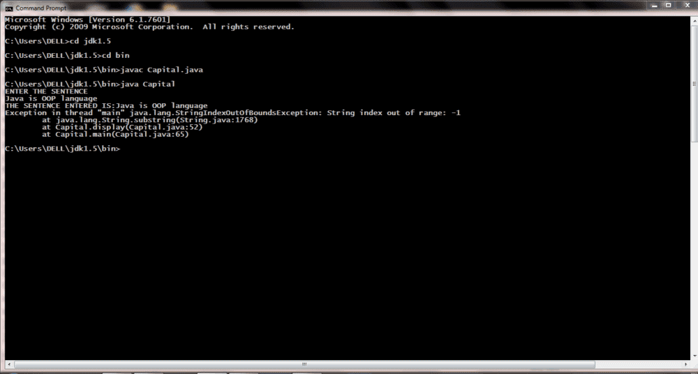

Summary:: I'm having problem with this source code.we need to find the frequency of the number of words beginning with an UPPERCASE Alphabet in a sentence.
The data members and member method must be according to the question given in the document.
though i could compile it but it's giving runtime error for STRING INDEX OUT OF BOUNDS EXCEPTION. I hope someone can help me point out where I'm missing the error.
Windows Command Prompt showing javac Capital.java and java Capital compiling and running, with the sentence Java is OOP language echoed, followed by a StringIndexOutOfBoundsException: String index out of range: -1 stack trace.

That means you have tried to access a character that is beyond the end of a string.

What if the string has no spaces? What does the index function return?
according to the question we have to assume that.
if it was not for the question,I agree with you that this point about white space character should be considered.
The error message tells you that something is wrong when you call the substring method in line 52. Try inserting the following line before line 52:
Java:
        System.out.println("j = " + j + ", i = " + i);
which will show you what is wrong, then work out how i and j have acquired these values.
My post was a hint as the index function returns a -1 when there are no spaces and so youve set your i variable to -1 with the possible and likely subsequent fail you observe.
You should test for it and decide what to do.

This is your problem. As written, the for loop starts at a point where sent.charAt(i) is a space. Which means that the condition in the while loop is always true. Which means that j will eventually exceed i, which is probably what substring is objecting to.
A while loop where the condition does not depend on a variable modified by the loop and which has no explicit break statement is asking for trouble.

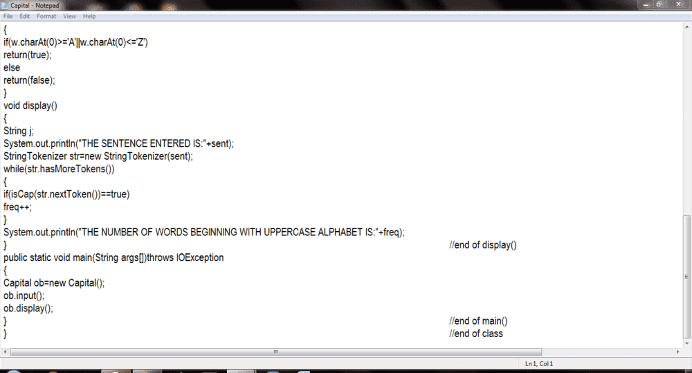

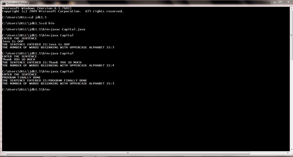

thanks your idea helped greatly i did that and saw that i needed to change while with if but encountered a problem that the program wouldn't consider the last word as last character isn't the whitespace.so i did it using StringTokenizer.
I'M UPLOADING THE SNIP OF CHANGES AND OUTPUT IN CASE ANYONE WANTS TO HAVE A LOOK AT IT.
BUT MORE SUGGESTIONS ARE ALWAYS WELCOME
  • Screenshot of Notepad showing the end of a Java class named Capital, with an isCap method checking if a word's first character is between A and Z, and a display method using StringTokenizer to count words beginning with uppercase letters.

  • Windows Command Prompt session compiling and running a Java program named Capital, which counts words beginning with an uppercase letter in an entered sentence, showing three runs and their printed output.
  • Windows Command Prompt window showing three runs of a Java program named Capital, each printing the entered sentence and the count of words beginning with an uppercase letter, with results of 3, 4 and 3.
thanks for your help.I came up with StringTokenizer and it's working fine now.
