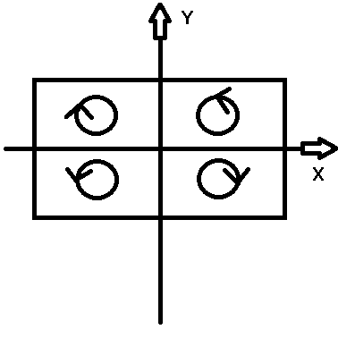

What I had in mind was imparting a "handedness" to the Euclidean plane and thinking about the sine. At 90 degrees, the sine of the angle is either +1 or -1 depending on whether ∠ABC is counter-clockwise (+90 degrees = left turn) or clockwise (-90 degrees = right turn).
This in turn allows one to consider counter-clockwise polygons with positive area and clockwise polygons with negative area.
Edit: updated the text to match the sign convention I really had in mind -- which matches the picture produced by @fresh_42
How about this solution?
with orientation x first then y.
