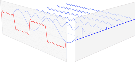

This picture might help show how the signal amplitude is plotted against frequency and time. This is from a Google Image search.
