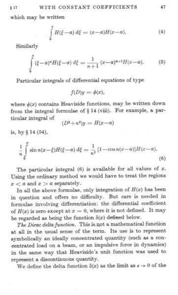

I agree different authors use different definitions for H(t)
Attached is the reason I like mine - it also happens to be the original.
