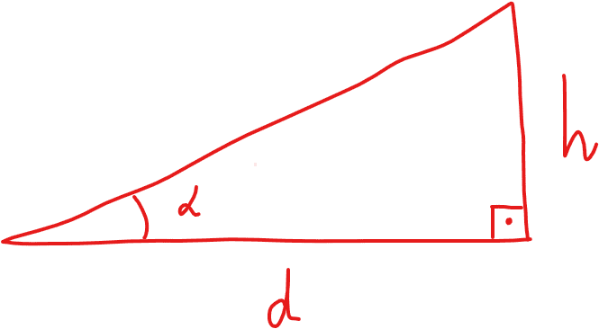

Imagine there is a building or similar thing that you want to measure. It's inaccessible or too tall to measure it directly so we'll use trigonometry because measuring the number of steps from it and the angle with a protractor is simpler.
To find the height it's possible to use the following formula.
$$h=d\tan(\alpha)$$.
However, this is not the ideal world. We want to achieve an accurate measurement and there is some uncertainty attached to all the values we take from the real world.
For the angle, we will assume a constant uncertainty.
$$\alpha = \alpha_{avg} \pm \alpha_{unc}$$ where $$\alpha_{unc}=0.001 \rightarrow \alpha=\alpha_{avg} \pm 0.001$$.
On the other hand, for the distance, the uncertainty will be a function of the distance itself since measuring longer distances is harder.
$$d=d_{avg} \pm d_{unc}$$ where $$d_{unc}=d_{avg}*0.1 \rightarrow d=d_{avg} \pm d_{avg}*0.1 =d_{avg} (1 \pm 0.1)$$.
In conclusion, the measured height will be
$$h=d_{avg} (1 \pm 0.1)\tan(\alpha_{avg} \pm 0.001)$$.

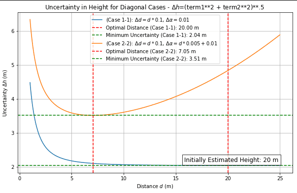

I'll rename some of the variables to make it clearer. The measured horizontal distance will be $$d \pm \Delta d,$$ where ##d## is the average of the measurements and ##\Delta d## will be the uncertainty. Similarly, the measured angle will be $$\alpha \pm \Delta\alpha.$$ The computed height will be $$h \pm \Delta h.$$
Due to the trigonometric nature of the problem, we know $$h = d\tan\alpha.$$ Now comes the new stuff for me (maybe I studied but I didn't remember it). The uncertainty in the result ##\Delta h## will be a result of the values from which ##h## is computed and their respective uncertainties. To be precise, $$\Delta h = \left| \frac{\partial h}{\partial d} \right| \Delta d + \left| \frac{\partial h}{\partial \alpha} \right| \Delta \alpha.$$ I don't have enough background to confirm the validity of that expression but it seems right. It implies that, if the function has a great slope, the resulting uncertainty will be bigger because a small variation in the input values will cause a big impact on the output.
Those partial derivatives can be computed because the function ##h## is known.
$$\frac{\partial h}{\partial d}=\tan\alpha.$$
$$\frac{\partial h}{\partial \alpha} = d\sec^2\alpha.$$

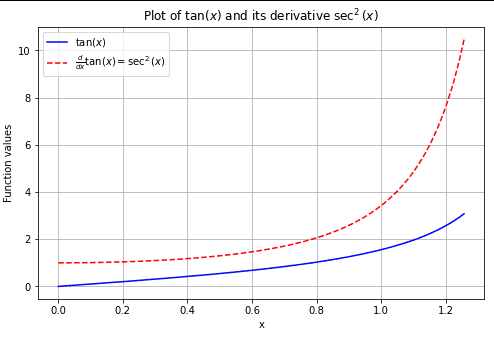

The distance ##d## will always be positive and the angle ##\alpha## will be constrained between ##0## and ##\pi/2## so we can ignore the absolute values because the functions are positive in the studied interval.

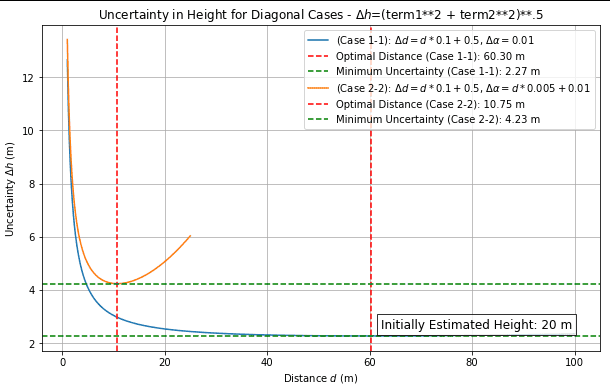

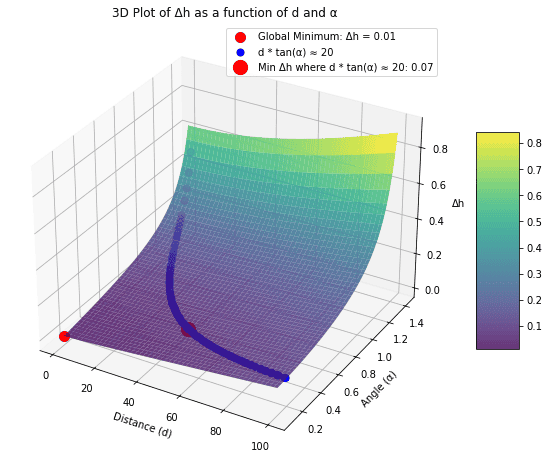

I want to find which ##d## generates the smallest uncertainty ##\Delta h## so it's necessary to write it as a function of ##d## by getting rid of ##\alpha## and derive. We know that $$\tan\alpha = \frac{h}{d}$$ and $$\sec^2\alpha = 1+(\frac{h}{d})^2.$$ As a result, we get the expression $$\Delta h = \frac{h}{d}\Delta d + d (1+(\frac{h}{d})^2) \Delta \alpha.$$ This by the way requires knowing ##h## which is not possible since that's the very objective of the problem. Remember, we wanted to find which ##d## will generate the most precise calculation of ##h##. Or in other words, finding the ##d## that minimizes ##\Delta h##. However, we can input an estimation of ##h## and continue the calculations from there.

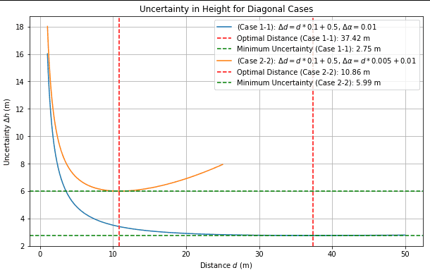

Finally, it's possible to define ##\Delta d## and ##\Delta \alpha## as desired and compute $$\frac{d\Delta h}{dd}=0$$ to find the minimum of the function ##\Delta h(d)##. I calculated it numerically though using code also created with the help of DeepSeek. These are the results for an estimated height ##h=20## for a couple of different cases where the definitions of ##\Delta d## and ##\Delta \alpha## are shown in the legend of the plot.
This is the code I used in case someone wants to play around with it.

# Run the analysis for diagonal cases
generate_diagonal_plots(h, d_unc_functions, alpha_unc_functions)[/CODE]

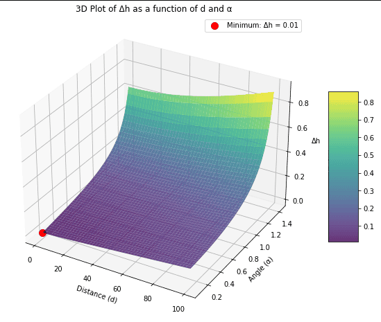

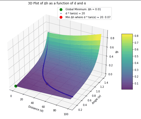

I have just realized it may be interesting to check if this can be transformed into an iterative process. I mean, at some point I had to assume the height of the building ##h## to find the best distance ##d## from where to measure it. Then, go and measure the height from that point and reuse it to find the best ##d## to repeat the process. I don't know how to implement it now though and I'm kind of exhausted. I think what I learned for now is enough.

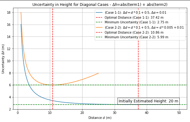

Juanda said:
Now comes the new stuff for me (maybe I studied but I didn't remember it). The uncertainty in the result Δh will be a result of the values from which h is computed and their respective uncertainties. To be precise,$$\Delta h = \left| \frac{\partial h}{\partial d} \right| \Delta d + \left| \frac{\partial h}{\partial \alpha} \right| \Delta \alpha.$$ I don't have enough background to confirm the validity of that expression but it seems right.

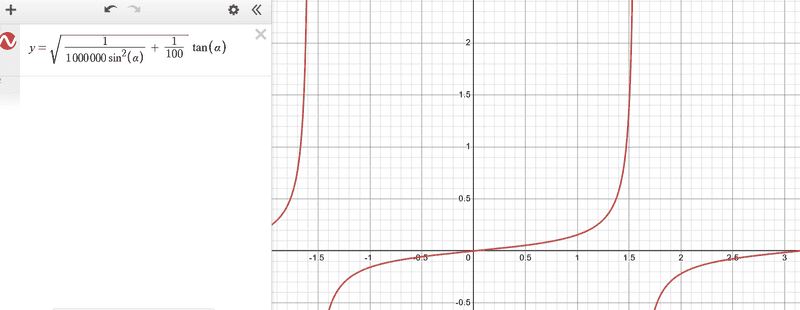

Not bad for an AI, but slightly pessimistic. If the errors are independent, they add in quadrature (see case ##f = AB## here . If the errors are independent, correlation ##\sigma_{AB}## is zero).

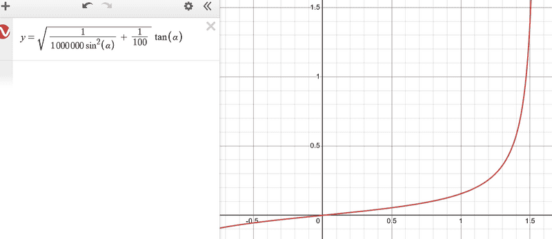

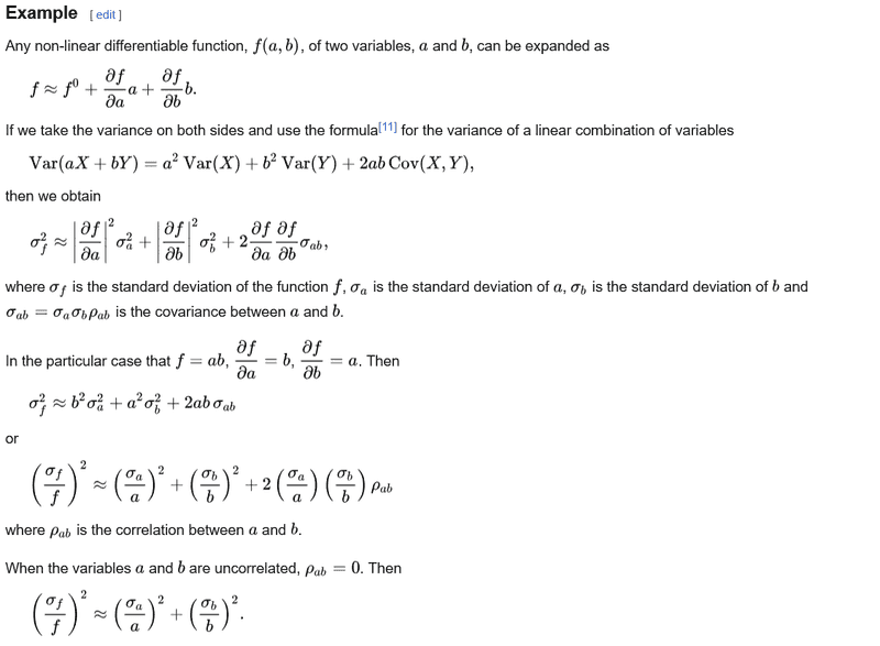

It's late, but the expression is something like $$\left ( \frac {\Delta h} {h} \right )^2 = \left ( \frac {\Delta d} {d} \right )^2 + \left ( \frac {\Delta \tan\alpha} {\tan\alpha} \right )^2 $$
With some manipulating for the second term we end up with (I think, need to check tomorrow): $$\left ( \frac {\Delta h} {h} \right )^2 = \left ( \frac {\Delta d} {d} \right )^2 + \left ( \frac 2 {\sin 2\alpha} \right )^2 \left (\Delta \alpha \right )^2 \tag {1}$$

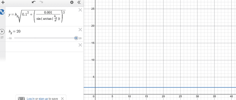

Your excursion with ##h/d## muddies the water; the measurement of ##\alpha## does not involve them.
Because of your choice for ##\Delta d## the first term in ##(1)## is fixed. The second term explodes for ##\alpha \downarrow 0## and for ##\alpha \uparrow \pi/2## as you found, but it has a minimum at ##\alpha = \pi/4##, which I kind of like.
I have to admit the expression came out of the AI with an approximation symbol ##\approx## instead of an equal symbol ##=## but it felt strange and I replaced it when writing it here. I guess I shouldn't have done that.
$$\Delta h \approx \left| \frac{\partial h}{\partial d} \right| \Delta d + \left| \frac{\partial h}{\partial \alpha} \right| \Delta \alpha.$$

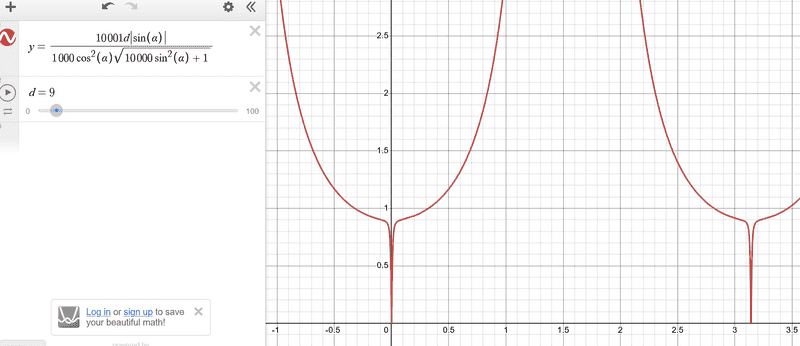

From the link you sent, it seems I'd need to combine these two expressions.
Linking it to this case, we have $$f=AB \rightarrow h=d\tan\alpha$$ so ##f=h##, ##A = d##, and ##B = \tan\alpha##.
Then, form the other row in the table we have (I'll use * to indicate it's not the same parameters as above) $$f^* = a^*\tan(b^*A^*)$$ so ##f^*=\tan(\alpha)##, ##a^*=1##, ##b^*=1##, and ##A^*=\alpha##.
Following the previous notation from the thread, I'll use ##\Delta x## to denote the standard deviation of the variable ##x## instead of using ##\sigma_x## as it is done in Wikipedia. Probably not the best choice of symbols but it's to keep it consistent with the thread. I changed the notation already in the third post and doing it again would just add more confusion to it.
In conclusion, $$\Delta h = d\tan\alpha \sqrt{\frac{\Delta d}{d}+\frac{\sec(\alpha)\Delta \alpha}{\tan\alpha}+2\frac{\Delta (d\tan\alpha)}{d\tan\alpha}}.$$
(I ignored the absolute values ##||## again because the function is positive in the defined interval.)
(I just noticed the Wiki is also using ##\approx## instead of ##=## but it confuses me. I'll keep using ##=## if it's not too wrong.)
The term ##\Delta (d\tan\alpha) = \sigma_{d\tan\alpha}## is the one I find most confusing. I think it's an indication of how related are they and if they influence each other but I don't get it yet. Also, are they really independent? I think in most cases it goes to 0 due to them being independent but I'd like to understand it better.
So the expression for ##\Delta h## shown before is the one I'd like to minimize. No need for further algebraic manipulation to simplify it. A computer can take care of it if needed.
The way it is now it's got two variables. You mentioned my attempt to get rid of one of them.

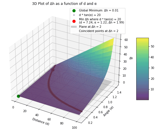

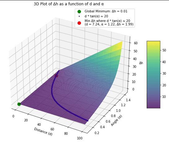

But I don't see why that approach is not correct. In fact, I see it as necessary. I used the relation between the variables to be able to find the ##d## that minimizes ##\Delta h##. It's true I needed a first guess for the height of the building ##h## to be measured but I think that'd be fine and could even be implemented into an iterative process as mentioned at the end of the post #3.
How could I accomplish the minimization of ##\Delta h## without using the substitution of ##\tan\alpha=h/d##?
Lastly, from the example above the table in the same Wiki link, it seems the table pivots on the idea of linearization of the functions.
Is simply wrong. You are missing the squares. The correct expression for the estimated standard deviation in ##h## is $$
\left ( \frac {\Delta h} {h} \right )^2 = \left ( \frac {\Delta d} {d} \right )^2 + \left ( \frac {\Delta \tan\alpha} {\tan\alpha} \right )^2 .$$
You misunderstand the meaning of ##\sigma_{ab}=\sigma_a \sigma_b \rho_{ab}\ ##, the covariance between ##a## and ##b##. It is zero if the measurement errors in ##d## and ##\alpha## are uncorrelated, which they are: one is measured with some surveyor's tool, the other with a protractor or a sextant. There is no reason to expect a measurement error in one of the two to have an influence on the error in the other.
I understand this is new for you. Perhaps check here on page 4.

The example does evaluate the derivatives ("In the particular case that ##f = ab##"...)
You're right I forgot the squares. I added them below.
$$\Delta h = d\tan\alpha \sqrt{\left(\frac{\Delta d}{d}\right)^2+\left(\frac{\sec(\alpha)\Delta \alpha}{\tan\alpha}\right)^2+2\frac{\Delta (d\tan\alpha)}{d\tan\alpha}}$$
All the procedure is taken from the Wiki link you shared. I don't see how it could be wrong except for the deadly typo of missing the squares you corrected. It should be the result after leaving ##\Delta h## alone and without yet considering the covariance to be null which is addressed below.
Got it. The plots from the Wiki article were especially helpful.

There is something I'm not getting with this approach because the fact that the two variables are independent creates a 3D surface and its minimum is not related to the distance that would minimize the uncertainty of the calculation.
Only a certain combination of distances and angles is to be expected from the measurements because they're related to the height of the building. So it'd be more of a curve instead of a surface. But then I go back to using ##\tan\alpha=h/d## and you said that only muddies the problem.
Juanda said:
I want to understand this topic in the general case and I don't see much added value in the algebraic manipulations to obtain a slightly simpler expression which is not necessary. I'd rather focus the effort on the parts I don't understand. I honestly don't understand what made you think that in the first place but it felt bad.
Point taken, I apologize.
Your expression still misses a square: ##\displaystyle \frac {d\;\tan\alpha}{d\alpha} = \sec^{\color{red} 2}\alpha ##.
Juanda said:
I think I'm not following here. I now have an expression for Δh which is a function of d and α. Do I start working on finding its minimum?
My 'mistake': the minimum absolute error isn't very exciting: it is zero for ##d=0## or ##\alpha=0##.
What I did in the paragraph preceding was to show that the relative error in ##h## is minimized for ##\alpha = \pi/4##. Its value is at least 10%. The second term ##0.001*2/\sin(2\alpha)## is virtually never making a difference.
How you can find a minimum ##\Delta h = 0.01## is a mystery to me. Didn't you say ##\Delta d = 0.1 d## ?
Or is it simply that you started the ##d## axis at ##d=0.1## ?
In the second figure I gather the blue line is where ##d\tan\alpha = 20## ? And your red dot minimum ##\Delta h## is when ##d = 40## m ? And what ##\alpha##? (Where I would expect a minimum ##\Delta h = 2## m for ##d=20## m and ##\alpha = \pi/4##)

We have $$h = d\tan\alpha.$$
The uncertainties of the measurements of the distance ##d## and the angle ##\alpha## are ##\Delta d## and ##\Delta \alpha## respectively and will be considered known functions. For example, ##\Delta d = 0.1d## and ##\Delta \alpha = 0.001## which was used in the previous post #7 (I noticed an error in the code that generated the 3D surface by the way after you pointed out the expected minimum value. More on that later.).
$$\left ( \frac {\Delta h} {h} \right )^2 = \left ( \frac {\Delta d} {d} \right )^2 + \left ( \frac {\Delta \tan\alpha} {\tan\alpha} \right )^2 \rightarrow \Delta h = h\sqrt{\left ( \frac {\Delta d} {d} \right )^2 + \left ( \frac {\Delta \tan\alpha} {\tan\alpha} \right )^2}$$
which is given by the case ##f = ab## when the uncertainties in the two measurements are not related.
Where ##h## and ##\Delta d## can be substituted, for ##\Delta \alpha## we need the case ##f^* = a^*\tan(b^*A^*)## which results in ##\Delta \tan\alpha = \sec(\alpha)\Delta \alpha##. (I think I explained it better in post #5 although I missed the square signs).
Finally, we can express the uncertainty in ##h## as
$$\Delta h = d\tan\alpha \sqrt{\left(\frac{\Delta d}{d}\right)^2+\left(\frac{\sec(\alpha)\Delta \alpha}{\tan\alpha}\right)^2}$$
If there is an error so far in this expression I certainly cannot find it. I don't substitute the expressions for ##\Delta d = 0.1d## and ##\Delta \alpha = 0.001## to keep it more general.
With that expression of ##\Delta h##, I can already work on minimizing it. Either through derivatives or numerically finding the lowest point in the 3D surface.
You are totally right to point out the strange values I had before. I took a closer look at the code and I realized I introduced a typo so ##\Delta d## was not correctly defined. I was plotting for ##\Delta d = 0.1## instead of ##\Delta d = 0.1d##. I corrected it and added a bit more info to the legend of the plot. I was printing results in the console but I didn't share that. Now the main information is all in the same place.
However, I noticed this method is too dependent on mesh refinement. I realized the red dot moved along the curve and the uncertainty was always extremely close to ##\Delta h = 2##.
It's when I realized that all that blue curve is pretty much at ##\Delta h = 2## which I confirmed by including a plane and calculating the intersection.
(The legend is not being displayed correctly for some reason. The orange points are the intersection between the curve and the plane.)
My conclusion from those results is that, at least for the defined ##\Delta d = 0.1d## and ##\Delta \alpha = 0.001##, the uncertainty almost doesn't change in the studied range (ignoring extreme angles) which is quite counterintuitive to me, to be honest.

I believe you want to apply that to the expression of ##\Delta h##, but is it possible? In there, both the numerator and denominator are squared. Still, I have applied a trigonometric simplification below as you suggested.
I'm having a hard time swallowing the conclusion from the numerical analysis. I'll try to find the minimum value of the surface with partial derivatives too. I should get the same result if the previous process was correct.
$$\frac{\sec\alpha}{\tan\alpha}=\frac{1}{\frac{\sin\alpha}{\cos\alpha}\cos\alpha}=\frac{1}{\sin\alpha}$$
$$\Delta h = d\tan\alpha \sqrt{\left(\frac{\Delta d}{d}\right)^2+\left(\frac{\Delta \alpha}{\sin\alpha}\right)^2}$$
$$\Delta d = 0.1d$$
$$\Delta \alpha = 0.001$$
$$\Delta h = d\tan\alpha \sqrt{0.1^2+\left(\frac{0.001}{\sin\alpha}\right)^2}$$
$$\frac{\partial \Delta h}{\partial d} = 0 \rightarrow \sqrt{\frac{1}{1000000 \sin^{2}\left({\alpha}\right)} + \frac{1}{100}} \tan\left({\alpha}\right) = 0 $$
The derivative becomes 0 in intervals of ##\alpha = n\pi## but our function only goes from ##0 < \alpha < \pi/2##.
$$\frac{\partial \Delta h}{\partial \alpha} = 0 \rightarrow \frac{10001d \left|\sin\left({\alpha}\right)\right|}{1000 \cos^{2}\left({\alpha}\right) \sqrt{10000 \sin^{2}\left({\alpha}\right) + 1}}=0$$
This expression has 2 variables. Seeing the results for some ##d## values it's possible to conclude the derivative becomes 0 in intervals of ##\alpha = n\pi## but our function only goes from ##0 < \alpha < \pi/2##.
So I arrived at the (0, 0) solution which is not too useful...
I'll try adding the ##\tan\alpha = h/d## again using an initial guess for ##h## which will be ##h_g=20##. This is because not all possible combinations of ##d## and ##\alpha## are possible. Their uncertainties may be uncorrelated but only a certain combination of values will actually describe the height of the building.
$$\Delta h = d\tan\alpha \sqrt{0.1^2+\left(\frac{0.001}{\sin\alpha}\right)^2} = h_g \sqrt{0.1^2+\left(\frac{0.001}{\sin(\arctan(\frac{h_g}{d}))}\right)^2}$$
Now I arrive again to the conclusion that no matter the distance, the uncertainty will be the same. I find it very counterintuitive but it's the result I get from that expression of ##\Delta h##. I feel like the result I got from post #3 made more sense. I checked this method with ##\Delta h = d\tan\alpha \sqrt{0.1^2+\left(\frac{0.001}{\sin\alpha}\right)^2}## using all the methods I can think of and the results and conclusions are the same. It's just that I have a hard time believing them.

Is it possible the formula for ##\Delta h## is like this?
$$\Delta h = \sqrt{\left(\frac{\partial h}{\partial d} \Delta d\right)^2 + \left(\frac{\partial h}{\partial \alpha} \Delta \alpha\right)^2}$$
It looks a lot like what I did in post #3 but it includes the squares mentioned in post #4 instead of using absolute values.
I'm aware the result will change because the root and squares don't cancel because of the sum.
If it is right, I don't know how to go from
to
$$\Delta h = \sqrt{\left(\frac{\partial h}{\partial d} \Delta d\right)^2 + \left(\frac{\partial h}{\partial \alpha} \Delta \alpha\right)^2}.$$
It looks like it comes from
$$\left(\frac{\partial h}{\partial h}\Delta h\right)^2 = \left(\frac{\partial h}{\partial d} \Delta d\right)^2 + \left(\frac{\partial h}{\partial \alpha} \Delta \alpha\right)^2 \rightarrow \Delta h = \sqrt{\left(\frac{\partial h}{\partial d} \Delta d\right)^2 + \left(\frac{\partial h}{\partial \alpha} \Delta \alpha\right)^2}$$
So the similarities with the expression you proposed are certainly there but I'm just guessing.
Comparing the results of post #3.
And this new version with the squares and square roots.
@BvU you mentioned how my initial guess was pessimistic. This new version with the squares has lower uncertainties as you predicted.
Juanda said:
I think there might be a misunderstanding here. In that instance, the d refers to the distance, not the derivative. Once again proving I didn't make the best choice for the symbols.
The derivative of ##\tan\alpha## is ##\sec^2\alpha##, not ##\sec\alpha##. There are a lot of ##d## so I don't know which one you are referring to. I do mean the derivative.
Compare (##{\bf\color {red} d}## is distance, ##d## is the infinitesimal) $$
dh =\frac{\partial h}{\partial {\bf\color {red} d}} d{\bf\color {red} d} +\frac{\partial h}{\partial {\alpha}} d{\alpha}$$ which for error propagation becomes $$
\begin{align*}
\left (\Delta h\right )^2 &=\left (\frac{\partial h}{\partial {\bf \color {red} d}}\right )^{\!2} \left (\Delta{\bf\color {red} d} \right )^{\!2}
+\left (\frac{\partial h}{\partial {\alpha}}\right )^{\!2} \left (\Delta{\alpha}\right )^2\\ \ \\
&=\left (\tan\alpha\right )^2 \left (\Delta{\bf \color {red}d} \right )^2
+ \left ({\bf \color {red}d} \sec^2\alpha\right )^{\!2} \left (\Delta{\alpha}\right )^2 \\ \ \\ \ \\
\left (\frac{\Delta h}{h}\right )^{\!2} &= \left (\frac{\Delta{\bf \color {red}d} } {\bf \color {red}d}\right )^{\!2}
+\left (\frac {\sec^2\alpha} {\tan\alpha}\right )^{\!2} \left (\Delta{\alpha}\right )^2
+\left (\frac {1} {\sin\alpha\cos\alpha}\right )^{\!2} \left (\Delta{\alpha}\right )^2
+\left (\frac {2} {\sin(2\alpha)}\right )^{\!2} \left (\Delta{\alpha}\right )^2
\end{align*}
\end{align*}$$
I think I get it now. Thanks!
However, I don't see the point in trying to minimize the relative uncertainty instead of the absolute uncertainty. In this very case, it's convenient because one of the variables goes away because of term cancellation due to the definitions of ##\Delta d## and ##\Delta \alpha## but it's not a general thing. If they weren't canceled, I'd have still needed to use ##\tan\alpha=h/d## with an initial guess for ##h##. Besides, the coordinates for minimum uncertainty and minimum relative uncertainty can be different. In which scenarios is it convenient to minimize the relative uncertainty?
