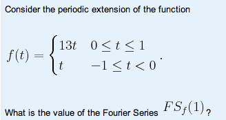

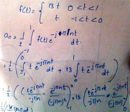

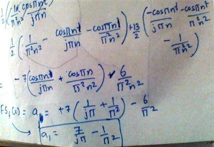

Uniman said:
https://www.physicsforums.com/attachments/425
It is necessary to remember that in a point $t_{0}$ where f(t) isn't continous, the Fourier Series converges to... $\displaystyle S_{0} = \frac{1}{2}\ \{\lim_{t \rightarrow t_{0} +} f(t) + \lim_{t \rightarrow t_{0} -} f(t) \}$ ... under the assumption that both limits exist...
