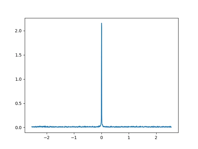

So, been back for a while. I left kinda disappointed with the noise performance of these tests. Syncing two radios with a common clock is work and it takes special hardware to boot. This got me thinking about trying to do things a different way. In the interim I've been reworking software for the RFSpace radios I've collected. These radios are different than most. An ADC is used to sample at 67MHz. This is followed by an AD6620 DSP receiver chip. Unlike the SDRplay radios, the AD6620 chip and all its algorithms are well documented. So, I have personal control over most of the hardware and the API used to run it.
Okay, NTP and its snazzier step child, PTP, are network protocols designed to synchronize computer clocks. NTPs target accuracy is 10ms while PTPs is 1us. Just knowing the time of day to 10ms just by plugging into a network is kinda amazing. 1us would be well into the range of being useful for this application. For now we'll stick with Ubuntu's stock NTP.
IQ data for the RFSpace radios is collected in 2048 sample data frames at a nominal rate of 196078 samples per second. This is the (nominal) 66,666,667 Hz ADC rate decimated by 340. Recording these data frames along with their time stamps to disk gives an uninterrupted stream of data for as long as one is willing to fill a disk. After 2 minutes or so (my current attention span) of data collecting, one should have a pretty decent measurement of the actual radio data rate. Time stamps are obtained using the system call clock_gettime(CLOCK_REALTIME,&tspec). For each radio I then fit the times to a straight line,
t(n) = r n + t0
where ##n## is the frame number. The parameter ##r## is the frame rate and ##t0## the start time for the radio. With two radios ##r_1## won't equal ##r_2## and likewise, ##t0_1## won't equal ##t0_2##.
Given these two fits, we may select segments of IQ samples that span the same time. Initial tests with two computers didn't work so great. Random 10ms offsets between clocks moves the correlation peak to a position that can't be predicted. Also, the variations from run to run of the measured data rates varies more than I expect based on the performance of these radios as radios.
To counter these issues, I switched to a single computer. This seems to have virtually eliminated the time offset problem. The measured data rates still bounces around by much more than I expect, however, the difference in measured data rates between the radios drifts around by about one Hz which is quite usable.
To compute the correlation between IQ data streams I first select a time range, ##(t_1,t_2)##. IQs are extracted from each radio data file that span these times. For time spans of a second or so the length of these IQ arrays will differ by some 1-10 samples or so which I ignore. Next, the DC offset is removed by subtracting the average of the IQ values for each array.
The next step is key. The radio center frequency was set assuming the nominal ADC clock rate. We need to frequency shift one of the IQ data sets by the appropriate amount. At a center frequency of 2MHz this frequency shift is obtained from our measured frame rates and is about 28Hz. Doing so yields a nice correlation peak,
This is from 1.7 minutes of data taken with a noise generator that's teed and fed into each radio. The time span is ##(t_1=10sec,t_210.5sec)## as measured from the start of the overlap of the IQ data.
This is still very much a work in progress. Moving to PTP from NTP should allow the radios to be on separate computers which need not be colocated.
