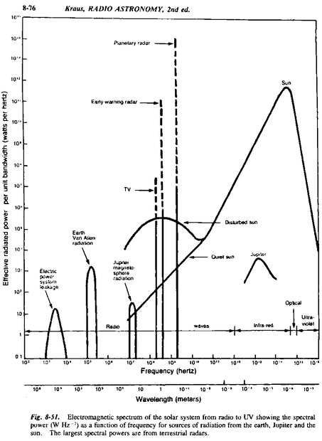

I'm still not getting the "can't see the sun" part.
How bright is the sun? Well, there is something over 1 kW/m2 integrated over wavelength, peaking in the visible. Call it 500 THz, and say we are looking at 5 GHz. So we're down 100,000 in frequency. Cubing it to get power, and we're at a picowatt-scale into the antenna.
How sensitve are radios? Microvolts are typical, and since impedances are ohm-scale, microvolts mean mictoamps. So again, picowatts.
So even a quiet, blackbody sun should be visible within terms of order one. As the sun's activity increases, it should be even more visible - the sun is far more interesting than a blackbody.

Get yourself a copy of Radio Astronomy, John D. Kraus.
Chapter 8. look at the difference between quiet and disturbed Sun.

I will pick up a text before putting up an antenna, for sure. However, I am still unclear as to how people can miss the sun.
Is the active sun "louder" than the quiet sun? Absolutely. The plot shows it, and effects on the ionosphere are substantial. But the numbers I ran make it look like the sun can be seen even as a black body. It can't get quieter than that.
I'm willing to believe that the terms of order 1 that I didn't consider conspire to be large - there's a famous case where they work out to 192π3 (and I once ran into a case where it was 49152π6 - talk about bad luck!) but if that's the problem, I want to know that that's the problem.
If nothing else, it will push me to higher frequencies - you win on temperature (21 cm is quite cold), and you win on angular resolution. However, that also pushes the receiver cost up.
