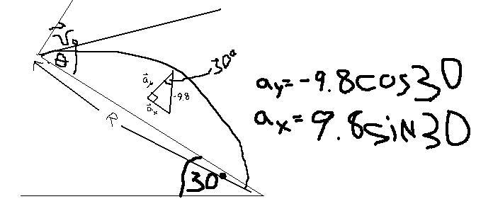

A rock is thrown from the top of a slope that makes an angle of 30 degrees with the horizontal. At what angle to the horizontal should the rock be thrown to get a maximum range? (Hint: pick the direction of the slope as a new x-axis and the normal to the slope as the new y axis. There will be acceleration in both axes.)
y=y_o+v_y_o*-.5*g*t^2
v_y=v_y_o+a_y*t
x=x_o+v_x_o+.5a*t^2
v_x=v_x_o
I drew a diagram of what is happening:
I need to solve for theta.
I don't think it will be 45 degrees to the horizontal, as you start on a slant. Even if i did think it was, i don't know where to plug 45 into.
Can anyone guide me on the right path? Offer any more hints?
Thanks.
You'll have to write the equations of motion for the projectile in the given coordinate system and find an expression for the range (the x coordinate when the y coordinate reaches zero --- the projectile lands). The trick will be in maximizing this expression with respect to the launch angle. I think it would be easier to first solve for the angle with respect to the x-axis. It can always be adjusted to the horizontal reference afterwards.
