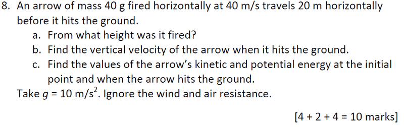

The question is in the attachment.
a) for the height i got 1.25m which you get by using displacement and acceleration. (t=20/40=0.5sec)
b) a=v/t, 10*0.5=5m/s
c) At initial point:
mgh= 0.040*10*1.25=0.5J
1/2mv^2=1/2*0.040*40^2=32J
Hits Ground:
mgh=0.040*10*0=0J
1/2mv^2=1/2*0.040*(20 or 40)^2 ? The answer is 32.5J I am not sure what happens here and how to get that. Do you add the energys from initial point together?

Since there are no losses due to wind resistance the initial energy equals the final energy. The velocity you use right before it hits ground is the composite velocity.

Hi Arty7! :smile:
Use components. :wink:
so.. mgh+1/2mv^2 0.5 +32 =32.5J
As for b use vy=g*t
a) Use the formula : h=(1/2)gt²
h=1[itex]/[/itex]2 [itex]\times[/itex] 10[itex]\times[/itex](0.5)²
Here I calculated t from the usual t = d[itex]\div[/itex]speed
t=0.5 s
Coming back to h,We get h as 1.25 m
b) v[itex]_{x}[/itex] = u = 40 m/s
v[itex]_{y}[/itex] = u[itex]_{y}[/itex]+gt=0+10[itex]\times[/itex]0.5
= 5 m/s
c) KE[itex]_{initial}[/itex] = (1[itex]\div[/itex]2)[itex]\times[/itex]m[itex]\times[/itex]v²
m=40 g and v= 40 m/s
= 0.5 J
KE[itex]_{final}[/itex] = (1[itex]\div[/itex]2)[itex]\times[/itex]m[itex]\times[/itex]v[itex]_{final}[/itex]²
Here you need to find the final velocity v[itex]_{final}[/itex] ; Find by v = u + gt
u=40 m/s and t=0.5 s
So v = 45 m/s
∴ KE[itex]_{final}[/itex] = 0.9 J if I'm right
Now KE[itex]_{final}[/itex] - KE[itex]_{initial}[/itex] = 0.4 J
Similarly Potential Energy [itex]\rightarrow[/itex]
PE[itex]_{initial}[/itex] = mgh
[itex]\rightarrow[/itex]40 × 10[itex]^{-3}[/itex] × 10 × 1.25
= 0.5 J
PE[itex]_{final}[/itex] = mgh
Here h is the equation of the trajectory,
We get h as 6.25 × 10[itex]^{-3}[/itex]
Now the potential energy is 2.5 × 10[itex]^{-4}[/itex] J
I guess PE(final) - PE(inital) = 2 × 10[itex]^{-4}[/itex] J
Now PE + KE = Answer
PE + KE = ?
I think you meant:
v=[itex]\sqrt{v^{2}_{x} + v^{2}_{y}}[/itex]
