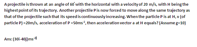

Maximum height attained by first projectile H = u2sin2θ/2g = 15m
If acceleration vector is assumed a = axi+ayj , then at H √(ax2+ay2) = 50 .
Now I need to use the given conditions to come up with another equation . Not sure how to proceed .
Please help me with the problem .

Please see if it is viewable now .

Figure out the centripetal acceleration at that point. Hint: Use the fact that the first projectile is at its apex at the point H.

Your suggestion has worked nicely .Thanks a lot :smile:.
I was just wondering what do we infer from the third line in the problem " such that the speed is increasing continuously ". We didn't make any use of it .
Your thoughts ?
You make use of that fact in determining the direction of the horizontal acceleration component. It tells you that ax is positive.
