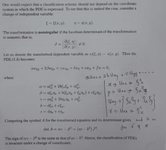

kindly see attached.
Partial differential equations
Printed page of a PDE classification text: a change of variables xi(x,y), eta(x,y) with Jacobian nonzero, transformed PDE coefficients A, B, C, and det A = ac - b^2 showing classification is invariant.
I am going through this page again...just out of curiosity, how did they arrive at the given transforms?, ...i think i get it...very confusing...

No, this is incorrect. You are missing the derivatives of w. For example:
u_x = w_\xi \xi_x + w_\eta \eta_x
and so on. There seems to be an implicit assumption that the transformation is linear or the higher derivatives would also contain higher derivatives of the new variables.

No, this is incorret. You do not know that w is a sum of xi and eta. It may be any function.

The correct approach should be, since ##ξ =ξ (x,y)## is a function of ##x## and ##y## and
##η= η(x,y)## being also a function of ##x## and ##y##, then using the transform ##ω(ξ,n)=u(x,y)##, we shall have
##u_x##=##\frac{∂ω}{∂ξ}⋅\frac{∂ξ}{∂x}##+##\frac{∂ω}{∂η}⋅\frac{∂η}{∂x}##
##u_x=ω_ξ⋅ξ_x+ω_η⋅η_x##
Quite interesting how they came up with the transformations...its some bit of work. To go straight to the point we have,
##u_x=ξ_x ⋅ω_ξ+η_x⋅ω_η## it follows that,
##u_{xx}=u_x ⋅u_x=(ξ_x ⋅ω_ξ+η_x⋅ω_η)(ξ_x ⋅ω_ξ+η_x⋅ω_η)=ξ^2_x⋅ω_{ξξ}+2ξ_x⋅ η_xω_{ξη}+η^2_x⋅ω_{ηη}##
##u_{xy}=u_x ⋅u_y=(ξ_x ⋅ω_ξ+η_x⋅ω_η)(ξ_y ⋅ω_ξ+η_y⋅ω_η)=ξ_xξ_y ω_{ξξ}+(ξ_x⋅ η_y+ξ_y⋅ η_x)ω_{ξη}+η_xη_yω_{ηη}##
##u_{yy}=u_y ⋅u_y=(ξ_y ⋅ω_ξ+η_y⋅ω_η)(ξ_y ⋅ω_ξ+η_y⋅ω_η)=ξ^2_y⋅ω_{ξξ}+2ξ_y⋅ η_yω_{ξη}+η^2_y⋅ω_{ηη}##
Now what they simply did in finding ##α## for e.g is by putting all coefficients of ##ω_{ξξ}## together, i.e on the pde of the form;
##au_{xx}+2bu_{xy}+cu_{yy}+...##
##α##= ##[aξ^2_x+2bξ_xξ_y+cξ^2_y]ω_{ξξ}##
Coming to the coefficients of ##ω_{ξη}##, we shall be getting ##β## i.e;
##β##=##[2aξ_x⋅ η_x+2b(ξ_x⋅ η_y+ξ_y⋅ η_x)+2cξ_y⋅ η_y]ω_{ξη}##
##β##=##[aξ_x⋅ η_x+b(ξ_x⋅ η_y+ξ_y⋅ η_x)+cξ_y⋅ η_y]ω_{ξη}##
the other transforms, ##δ, ϒ ##and ##∈## can be found similarly... i always try to use my own way of thinking ...and also utilizing your input...much appreciated guys...cheers @Orodruin thanks mate. Bingo!
