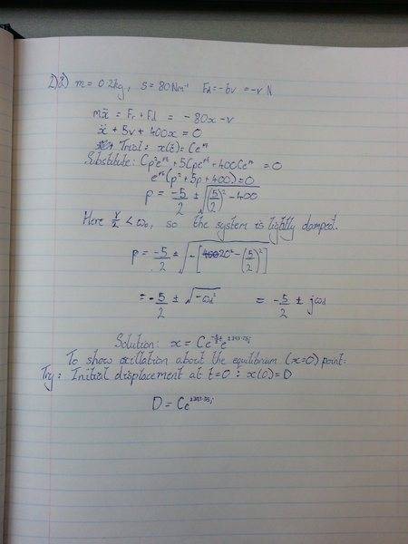

The problem is question 2(a) in the attached pdf. I seem to find myself at a dead end and am not sure where to go from here - I will attach my working in a separate file, but basically I need to show that the oscillator passes/crosses over the x = 0 boundary at a positive time, but I don't seem to be able to do that (or have enough information to) without ending up with nothing, or an impossible equation, like an exponential term = 0.

  • Handwritten derivation of a damped oscillator with m = 0.2 kg, S = 80 N/m, and F_d = -6v, solving m x'' + 5v' + 400x = 0 with a trial solution x = Ce^(pt), giving roots p = -5/2 ± j√(...), with the solution x = Ce^(-5t/2)e^(j...t).

Your picture is half illegible. Seems you do find an ##\omega## though.
However: your try with an intial displacement of 0 of course doesn't let the thing oscillate !
free tip: work with symbols, not with numbers. Only at the last moment, if/when a value is needed, subtitute values.

ω is 20 rads-1, from the equation (I have shown it only with values substituted):
p = -γ/2 +/- √[ω2 - (γ/2)2]
where ω2 = 400 and γ = 5\
And I set x(0) = D, not 0, as x is a function of t, is that incorrect?
No, that's correct. But it looks a lot like a zero on my screen.
Your Solution
Handwritten solution fragment showing x = Ce^(-5/2 t) times an exponential factor that is partly illegible, with a small symbol or subscript after it.
has ##x=Ce^{-{5\over 2}t} e^{\rm illegible}## when originally it was
Handwritten equation x(t) = Ce^(pt), with the exponent written as pt.
( so probably ##x=Ce^{pt} ## ?) and you found two ##p##. What happened to the second ?

has ##x=Ce^{-{5\over 2}t} e^{\rm illegible}## when originally it was View attachment 225682 ( so probably ##x=Ce^{pt} ## ?) and you found two ##p##. What happened to the second ?

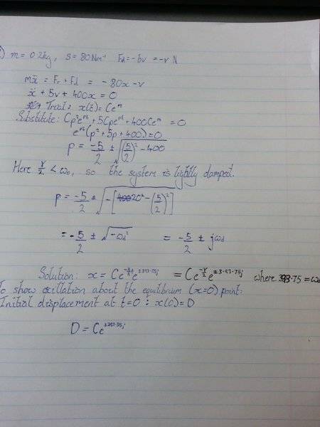

I'll try to attach a better photo, but the second p is included in the e+/- 393.75j
  • Handwritten damped oscillator derivation on lined paper: m = 0.1 kg, S = 80 N/m, Fd = -6v = -v N, mx'' + 5v + 400x = 0, substitution to characteristic equation p = -5/2 ± j·ω_d with underdamped solution x = Ce^(-2.5t) e^(±j393.75t), and initial displacement D = Ce^(±j393.75t).
Ah, I've just realized that the photo quality is significantly decreased by uploading it here. Apologies for that
You need to rethink your solution. A second order differential equation needs two integration constants (one for ##x## and one for ##\dot x## if you want to put it that way).
If there are two ##p## to solve the characteristic equation, then ##C_1 \,e^{p_1 t}## is a solution and so is ##C_2 \,e^{p_2 t}##.
