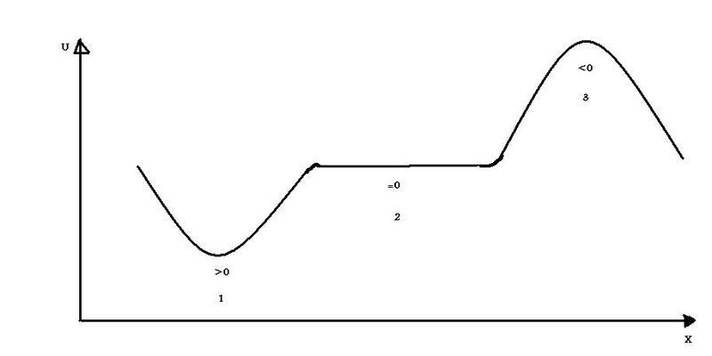

Alright so I've got a potential energy equation U(x) = E/β^4(x^4+4βx^3-8(β^2)x^2) and U'(x) = E/β^4[4(x^3) + 12β(x^2) - 16(β^2)x] (where β and E are constants) that describes a particle of mass m which is oscillating in an energy well. I solved for where the system has equilibrium positions through simple differentiation of U(x). (an equilibrium is at x=β and x=-4β) Now I have to find the angular frequency about each equilibrium position and estimate how small the oscillations should be around the equilibrium position.
N/A
I figure that since dU/dt = ma, I can differentiate U(x), equate it to acceleration, and solve for ω. However, the equation for U(x) is rather messy, and I still don't know across which distance the particle is oscillating. Any ideas?

this is diagram U(x)
1-equilibrium position(STATIC)[tex]\left.\begin{matrix} \frac{\partial^2 U}{\partial x^2} \end{matrix}\right|_{X=x_{1},x_{2}}> 0[/tex]
2-indfferent[tex]\left.\begin{matrix} \frac{\partial^2 U}{\partial x^2} \end{matrix}\right|_{X=x_{1},x_{2}}= 0[/tex]
3-equilibrium position(not static)[tex]\left.\begin{matrix} \frac{\partial^2 U}{\partial x^2} \end{matrix}\right|_{X=x_{1},x_{2}}< 0[/tex]

The equilibrium points are correct. Write up the Taylor expansion of U(x) around both of them and stop at the second order term.
