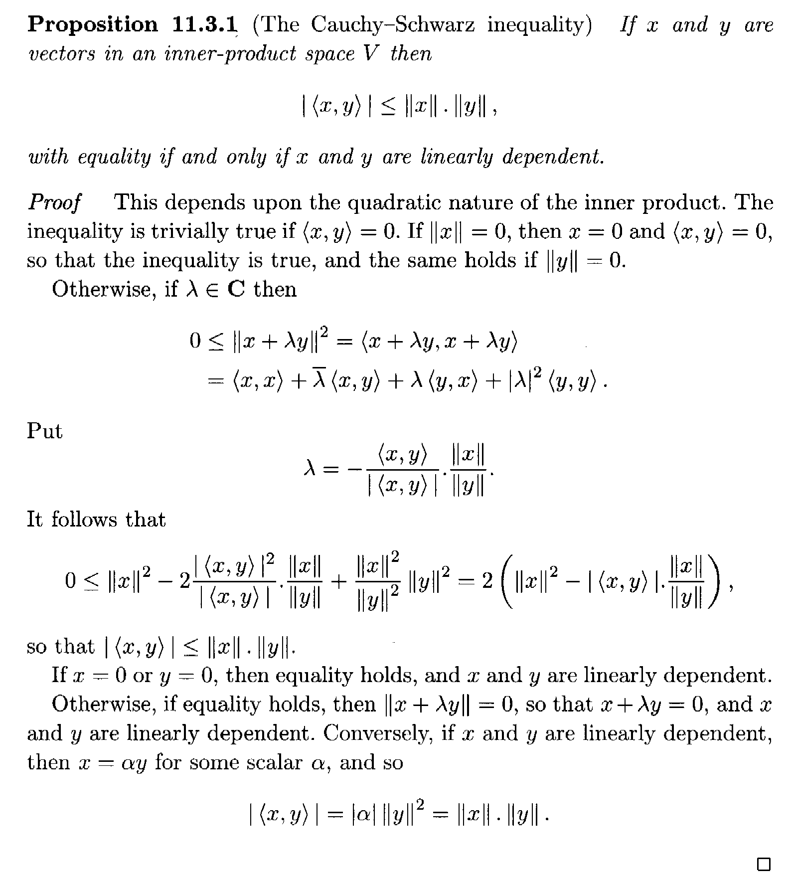

I am reading D. J. H. Garling's book: "A Course in Mathematical Analysis: Volume II: Metric and Topological Spaces, Functions of a Vector Variable" ... ...
I am focused on Chapter 11: Metric Spaces and Normed Spaces ... ...
I need some help to fully understand the proof of Proposition 11.3.1 ...
Garling's statement and proof of Proposition 11.3.1 reads as follows:View attachment 8956I need help with exactly how Garling concluded that with his substitution for $$\lambda$$ ... we have
$$\lambda^2 \langle x, y \rangle = \frac{ \langle x, y \rangle^2 }{ \mid \langle x, y \rangle \mid^2 } \frac{ \| x \|^2 }{ \| y \|^2 } \| y \|^2 = \| x \|^2$$ ... ... My problem is what sign (plus or minus) and value do we give to $$\langle x, y \rangle^2$$ ... Garling seems to treat $$\langle x, y \rangle^2$$ as if it were equal to $$ \mid \langle x, y \rangle \mid^2$$ ... and cancels with the denominator ... or so it seems ...?
But ... $$\langle x, y \rangle$$ is a complex number, say $$z$$ ... and so we are dealing with a complex number $$z^2 = \langle x, y \rangle^2$$ ... and, of course, $$z^2$$ is neither positive or negative ... ... ? ... so how do we end up with
$$\lambda^2 \langle x, y \rangle = \| x \|^2$$Hope that someone can help ...

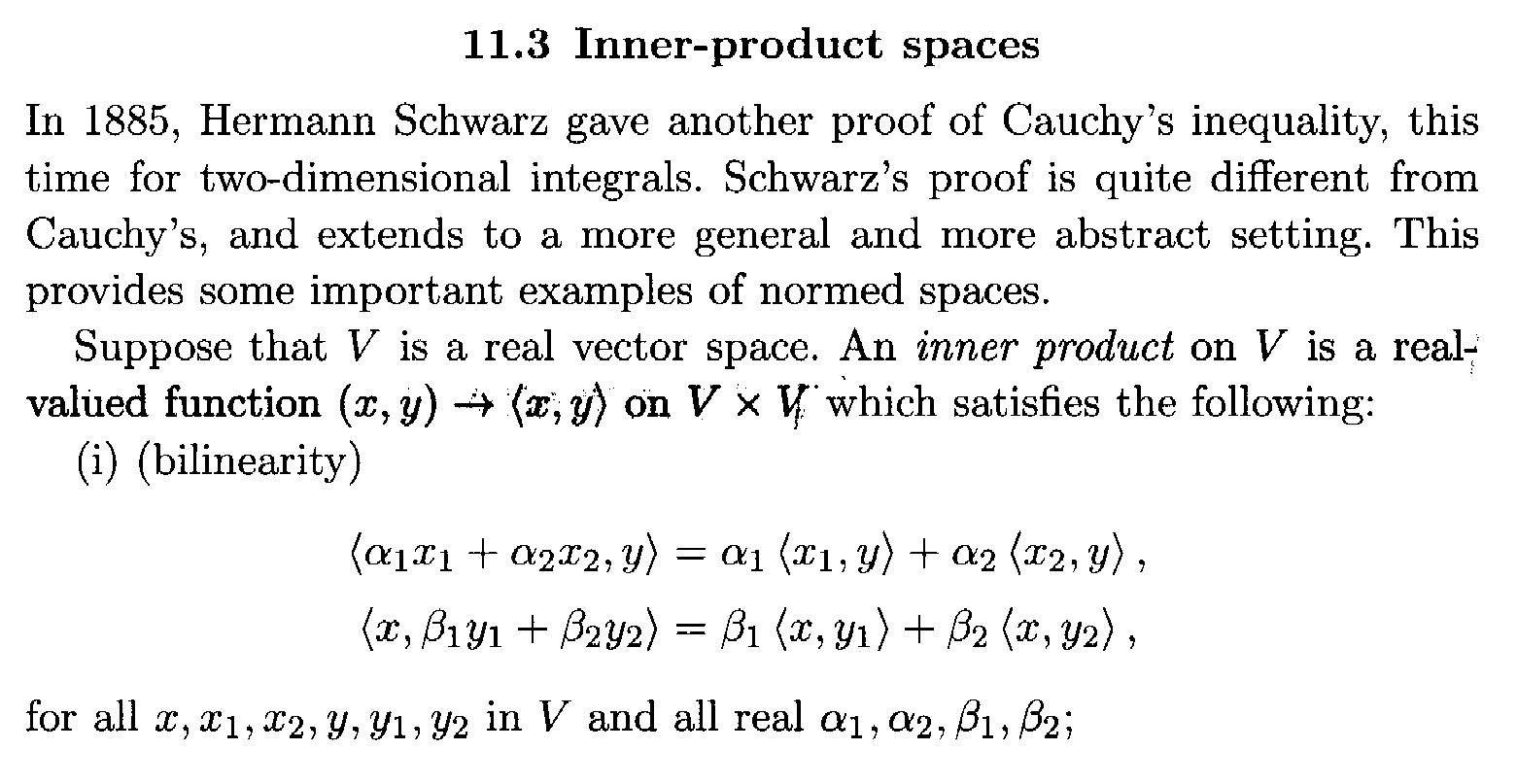

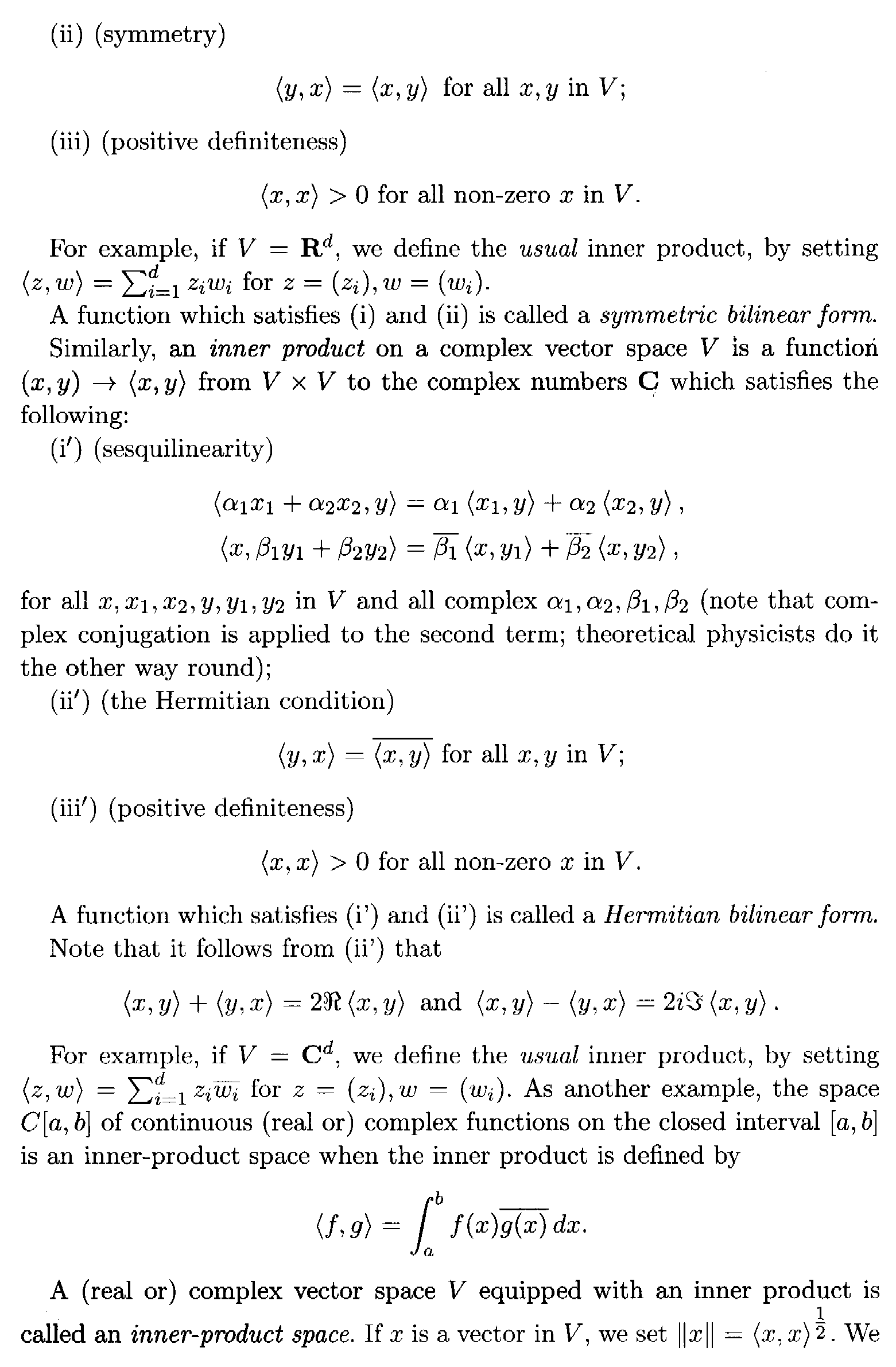

Peter=========================================================================================It may help readers of the above post to have access to Garling's introduction to inner product spaces where he gives the relevant definitions and notation ... so I am providing access to the relevant text as follows:
Hope that helps ...
Peter
In fact, $$\langle x, y \rangle^2$$ does not occur anywhere in Garling's proof. The proof contains the terms $\overline{\lambda}\langle x, y \rangle$ and $\lambda\langle y, x \rangle$. In each of those cases, $\langle x, y \rangle$ gets multiplied by its complex conjugate $\langle y,x \rangle$, so that the product is equal to $|\langle x, y \rangle|^2$.
Hmmm ... yes ... you're right of course...
I should have been more careful when I was writing out the details of the proof ...
Thanks for the help ...
