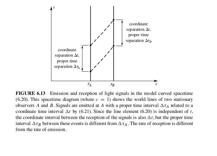

  • #38
Thank you everyone..
So we can't have a 'Three perpendicular rods and a clock' as a coordinate system throughout a curved spacetime , although we may use it in a small region.
Now below is an example from *Hartle,pg 127* .
Here we've a metric given as ##d s^2=-\left(1+\frac{2 \Phi\left(x^t\right)}{c^2}\right)(c d t)^2+\left(1-\frac{2 \Phi\left(x^i\right)}{c^2}\right)\left(d x^2+d y^2+d z^2\right)##
The figure explains what's going on
Author says :
"The coordinate separations between the two emissions at location ##x_A## are
##\Delta_t## and ##x= y =z=0##".Now my questions are:
1) with respect to whome are A and B stationary?
2) in this particular example do coordinates (x, y, z) have any physical significance?
I'm confused to be honest.
  • #39
Kashmir said:
1) with respect to whom are A and B stationary?
"Stationary" has no physical meaning. In general, stationary means with constant spatial coordinates.
However, this is not just an abstract example of a metric. It's intended to represent the gravitational field outside the Earth (with the appropriate potential function, as specified by Hartle). So, stationary suggests with respect to the Earth.
You would, of course, need some physical process to determine the value of ##(x, y, z)## at the locations where the experiment takes place. In Newtonian physics, because there is only one possible space and time and everything is Euclidean, this is simple. In curved spacetimes, this is more complicated. Nevertheless, you can imagine that given any location outside the Earth, you can have a consistent physical process to determine its coordinates.
Yes, in the sense that we expect that metric to represent the spacetime outside the Earth. You can't allocate ##x, y, z## coordinates arbitraily.
  • #40
Careful. There is a physical meaning to the term for a certain class of curved spacetimes. See my further comments below in response to the OP.
Kashmir said:
So we can't have a 'Three perpendicular rods and a clock' as a coordinate system throughout a curved spacetime with the same properties as a global inertial frame in flat spacetime , although we may use it in a small region.
See the bolded addition I made above. It's important. See below.
With respect to the gravitating body. Note, though, that the term "stationary" has two different possible meanings:
(1) The object has constant spatial coordinates. This is, of course, coordinate dependent, and in general does not tell you anything useful physically. In fact, some coordinate charts don't even support this meaning, since not all coordinate charts have one timelike and three spacelike coordinates.
(2) The object is "hovering" at a constant distance from a gravitating body whose gravitational field does not change with time. (The more technical definition is that the object's worldline is an integral curve of a timelike Killing vector field.) Both A and B meet this definition in the scenario you give, and this definition, unlike the one above, does tell you something physically meaningful.
In this particular example, yes, because the coordinates have been carefully chosen so that both meanings of "stationary" given above match: objects such as A and B, whose spatial coordinates are constant (note that this requires that the coordinate chart we chose has one timelike coordinate, ##t##, and three spacelike coordinates, ##x##, ##y##, and ##z##--but you can't just tell this from the names of the coordinates, you have to look at the metric), also are "hovering" at a constant distance from a gravitating body whose gravitational field is not changing with time. That is only possible in special scenarios like this one, where there is a gravitating body whose gravitational field is not changing with time.
  • #41
Expanding further on my previous post, with regard to this point:
In the scenario you describe, we do have "three perpendicular rods and a clock" at each event; but they do not match up with the coordinates t, x, y, z in the same way as they would in a global inertial frame in flat spacetime. Clocks at rest in these coordinates do not tick coordinate time ##t## (unless they are at spatial infinity, where the potential ##\Phi(x)## goes to zero), and rulers do not exactly measure coordinate intervals ##x##, ##y##, ##z## (unless, again, they are at spatial infinity, where ##\Phi(x)## goes to zero). At finite ##x##, ##y##, ##z##, the coefficients in the metric give correction factors that you have to apply to convert coordinate intervals into proper intervals, i.e., to times ticked off by clocks and distances measured by rulers.
  • #42
You mean Spacelike coordinates ?
PeterDonis said:
constant distance
What distance are we talking about here? ##ds^2##?
Which time? coordinate time?
  • #43
I think a lot of your questions are answered in Chapter 7. With something like GR perhaps you should try to press on instead of stopping in your tracks. Park these questions for now. No book can explain everything at once.
  • #44
Any coordinate that is "spatial" will have to be spacelike, yes.
The integral of ##ds^2## along a spacelike curve of constant coordinate time.
If the time coordinate is chosen properly, which it is in the example you give, yes. The more technical definition is that the spacetime is stationary if it has a timelike Killing vector field. One can always choose a time coordinate ##t## such that the metric is independent of ##t## in a spacetime that has a timelike Killing vector field (proving this is often an exercise in GR textbooks).
