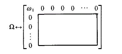

I will talk here about the first part of the proof:" Let us start with the characteristic equation.It must have at least one root,call it w1.Corresponding to w1 there must exist at least one nonzero eigenvector |w1>.Consider the subspace v1(of n-1 dimension) of all vectors orthogonal to |w1 >.Let us choose as our basis the vector |w1> normalized to unity and any n-1 orthonormal vectors in v1.In this basis Ω has the following matrix{picture1}
The column 1 is just the image of |w1> after Ω has acted on it.Given the first column , the first row follows from the hermiticity of Ω.
The characteristic equation now takes the form (w1-w)*(determinant of the boxed submatrix)=0.
{picture3}

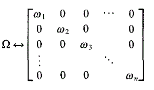

{picture2}"
My Question:As we can choose any n-1 orthonormal vectors in v1 and |w1> as a basis what guarantee that we will get the same eigenvalues if we changed the chosen n-1 orthonormal vectors in v1?
Matrix with first column (ω1, 0, 0, ..., 0) transposed, first row ω1 0 0 0 ... 0, and a boxed lower-right submatrix of unspecified entries, with the Ω-arrow pointing to the first column.
Diagonal matrix with entries w1, w2, w3 down the main diagonal, continuing with dots to wn in the bottom-right corner, and zeros everywhere else; labelled Omega equals this matrix.

picture1,picture3,picture2 respectivly.
If you did not get the same eigenvalues it would not be the same operator. There is no guarantee that you will pick the eigenvectors, but you see to that later.

But there is another question.why the first raw turned out to be zero? he said because of hermiticity but i didn't get it.

  • Block matrix with omega_1 in the top-left corner, zeros across the first row and first column, and an unfilled block below; labelled Omega on the left with a double arrow.

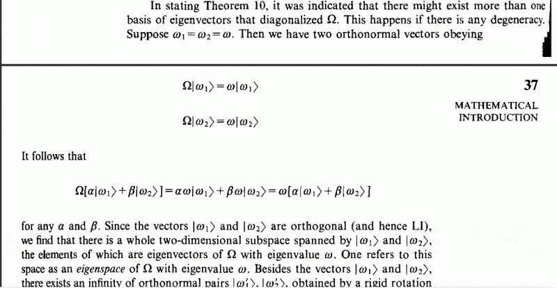

But in the book I'm reading "principles of quantum mechanics" by R.shankar,he states that the two eigenvectors of same eigenvalue are orthogonal here is a capture from the page:
Book page excerpt on degenerate eigenvectors: Omega|omega1> = omega|omega1> and Omega|omega2> = omega|omega2>, followed by the linear combination alpha|omega1> + beta|omega2> shown to be an eigenvector with eigenvalue omega.

But in the book I'm reading "principles of quantum mechanics" by R.shankar,he states that the two eigenvectors of same eigenvalue are orthogonal here is a capture from the page:View attachment 79746
He's saying that if there are two eigenvectors with the same eigenvalue, then there exist two orthogonal eigenvectors with that eigenvalue. He's not saying that any two eigenvectors with the same eigenvalue are orthogonal.

I deduced from the replies that the hermitian operators that have eigenvectors with distinct eigenvalues,these eigenvectors must be orthogonal to each other.
But if they have the same eigenvalue they are not necessarily orthogonal but we can transform them to orthogonal by gram-shmidet procedure or they may exist.
That's right.
