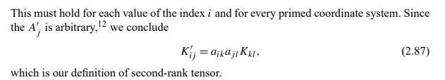

Prove that ##K_{ij}## is a tensor using quotient theorem.
Tensor analysis and quotient theorem.
$$K'_{ij}A'_{jk}=B'_{ik}=a_{ip}a_{kq}B_{pq}=a_{ip}a_{kq}K_{pr}A_{rq}=a_{ip}a_{kq}K_{pr}a_{jr}a_{kq}A'_{jk}$$$$K'_{ij}=a_{ip}a_{kq}a_{kq}a_{jr}K_{pr}$$
Can someone point out my mistake? What I've found shows that K is not a tensor.
It is different from my book and I cannot find my mistake. According to book K should be a 2nd-rank tensor.

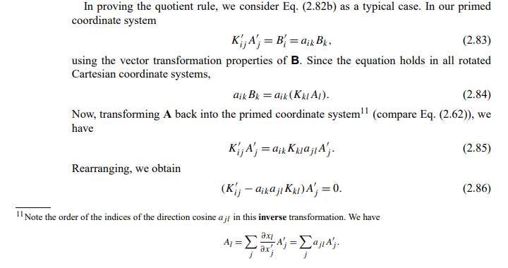

You use k for a dummy/summation index on the right, but it is already used as a free index on the left.
In last step I want to write ##A_{rq}## in prime corrdinates. So I had to use "k" again ... I wanted to prove using this method which is used by the book. Does this method work for my question in post #1?
But you can't. "k" is fixed by the left side of the equation, so you can't "sum for all k" on the right side of the equation.

$$K'_{ij}D'_k=X'_{ijk}=a_{ip}a_{jq}a_{kr}X_{pqr}=a_{ip}a_{jq}a_{kr}K_{pq}D_{r}=a_{ip}a_{jq}a_{kr}K_{pq}a_{kr}D'_k$$$$K'_{ij}=a_{ip}a_{jq}a_{kr}a_{kr}K_{pq}$$
I am trying to use my book's method. This method worked for equation in post #6 but It doesn't work for equation in post #1 and it doesn't work in this post as well ... I dont know why !

##K'_{ij}D'_k=X'_{ijk}=a_{ip}a_{jq}a_{kr}X_{pqr}=a_{ip}a_{jq}a_{kr}K_{pq}D_{r}=a_{ip}a_{jq}K_{pq}a_{kr}D_{r}=a_{ip}a_{jq}K_{pq}D'_k##
I've found my mistake. Thanks for your help @Hill ;)
