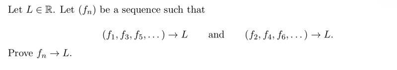

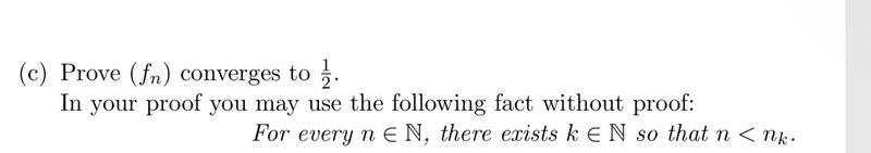

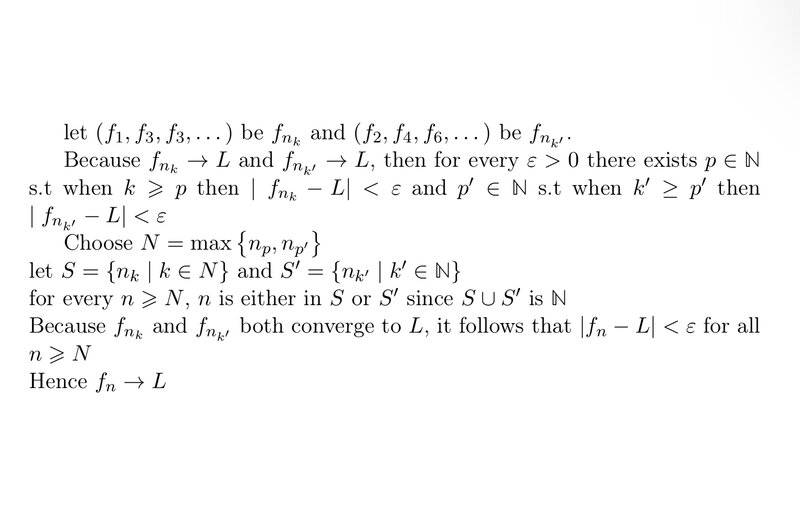

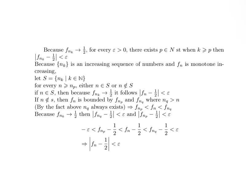

In the photos are two proof questions requiring proving convergence of sequence from convergent subsequences. Are my proofs for these two questions correct? Note in the first question I have already proved that f_n_k is both monotone and bounded
Thanks a lot in advance!
You lost me on your first proof. Note that ##f_n## is monotone increasing.
PS if I asked you to state why you think the first proposition holds, what would you say? Without any calculations, why must ##f_n## converge to ##\frac 1 2##?
The proposed proofs may be correct, but they certainly can be made more clear.
First, can you show that ##f_n \le 1/2 \ \ \forall n\in \mathbb N##?
Then start with an arbitrary ##\epsilon \gt 0## and see how far you can get.

Where did I lose you? I wrote that f_n is monotone increasing in the first proof?
Okay, I can see what you are doing now.
Proving the set of indices not in the subsequence converges is really roundabout. Given ##\epsilon>0## there exists ##n_k## such that ##|1/2-f_{n_k}|<\epsilon##. What can you say about ##f_n## for any ##n>n_k##? Don't think about whether it's part of the subsequence or not.
Let [itex]\epsilon > 0[/itex]. Then by convergence of the subsequence there exists [itex]K \in \mathbb{N}[/itex] such that if [itex]k > K[/itex] then [tex]\tfrac12 - \epsilon < f_{n_k} \leq \tfrac12.[/tex] But by monotonicity, we have [itex]f_{n_k} \leq f_n \leq f_{n_{k+1}} \leq \frac12[/itex] for every [itex]n_k < n < n_{k+1}[/itex]. It then follows that [tex]\tfrac12 - \epsilon < f_{n_K} \leq f_n \leq \tfrac12[/tex] for every [itex]n > n_K[/itex], showing that [itex]f_n \to \frac12[/itex].

fn>fnk since nk is a sequence of increasing numbers?

Let ϵ>0. Then by convergence of the subsequence there exists K∈N such that if k>K then 1/2−ϵ<fnk≤1/2.
wait why did the epsilon on the right hand side disappear?

If any ##f_{n_k}## is larger than 1/2 and they are monotonic increasing, can you prove that they must all be significantly greater than 1/2 from that point on? What does that say about the convergence to 1/2?

I don't think there are any mistakes, but the consensus is that you that they could be simpler. In the second proof, you spend a lot of time unnecessarily abstracting the concept of odd and even numbers. And the main N-epsilon details get omitted somewhat.
For example, for the second one I would do:
Let ##\epsilon > 0##. From the convergence of the odd and even subsequences, there exist ##N_1, N_2## such that if ##n## is odd:
$$n > N_1 \implies |f_n - L| < \epsilon$$And if ##n## is even:$$n > N_2 \implies |f_n - L| < \epsilon$$Let ##N = \max\{N_1, N_2\}##, then:
$$n > N \implies |f_n - L| < \epsilon$$Hence ##f_n \to L##.
My proof is quite formulaic and if someone asked for more details, you can simply add more detail or justification at any step. Whereas, in your proofs, the logic is a little jumbled.
PS also if I did make a mistake in my proof, it would be much easier to identify where one step does not follow from another.
The main point is that as your proofs get more difficult, my approach would generalise better. Whereas, your proofs are likely to become labyrithine. That's something to think about.

This is a good beginning exercise in formal proofs. Suppose there is an ##f_{n_k} \gt 1/2## and they are monotonic increasing. Can you formally prove that they can not converge to 1/2?
