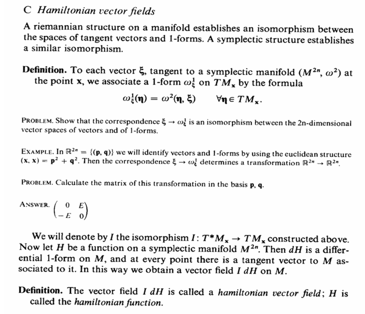

Regarding the definition of $$I$$, I followed the Arnold's notation:
Ok then, we have a vector field $$V_H$$ tangent to the integral curve given by the flow equation written in the question. Then we take another function $$f$$ that has perhaps another flow equation associated, is this right? For me, this makes sense considering that the Lie brackets measure the non-commutativity of two fluxes, and Poisson brackets are related to Lie brackets. So there are two vector fields associated with points in the manifold, and they can be taken as arguments of a two-form naturally existing in the manifold. Going on with my confusion about this point, is this two-form again a function because it takes an element of a manifold (the vector of a tangent bundle) and gives a real number? But how could Poisson bracket give both vectors and forms?
