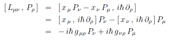

The problem statement is to prove the following identity (the following is the solution provided on the worksheet):
The definitions of [itex]L_{\mu \nu}[/itex] and [itex]P_{\rho}[/itex] are apparent from the first line of the solution.
I get to the second line and calculate the commutators explicitly:
[itex]-i\hbar(\partial_{\rho}x_{\mu}-x_{\mu}\partial_{\rho})P_{\nu}+i\hbar(\partial_{\rho}x_{\nu}-x_{\nu}\partial_{\rho})P_{\mu}[/itex]
The derivatives of the coordinates give the metric tensor e.g. [itex]\partial_{\rho}x_{\mu}=g_{\rho \mu}[/itex]
Calculating the derivatives of the coordinates and rearranging I get:
[itex]-i\hbar g_{\rho \mu}P_{\nu}+i \hbar g_{\rho \nu}P_{\mu} +i\hbar(x_{\mu}\partial_{\rho}P_{\nu}-x_{\nu}\partial_{\rho}P_{\mu})[/itex]
The first two terms are the solution I'm looking for, so I'd deduce the last term should be equal to zero.
Is this correct? and if it is, how do I prove that the last term is in fact equal to zero?

The last term should not be there. You need to be careful when evaluating [itex]-i\hbar(\partial_{\rho}x_{\mu}-x_{\mu}\partial_{\rho})P_{\nu}+i\hbar(\partial_{\rho}x_{\nu}-x_{\nu}\partial_{\rho})P_{\mu}[/itex]
For example, if you bring in the ##P_{\nu}## in the first term you get ##-i\hbar(\partial_{\rho}x_{\mu}P_{\nu}-x_{\mu}\partial_{\rho}P_{\nu})##
The first term in the parentheses should be interpreted as ##\partial_{\rho}(x_{\mu}P_{\nu})## where the derivative acts on the product of ##x_\mu## and ##P_{\nu}##.

Jesus, I was completely dumbfounded and it was so obvious. Now that I've re-done it I don't even know how I was missing it. Thank you a lot!
