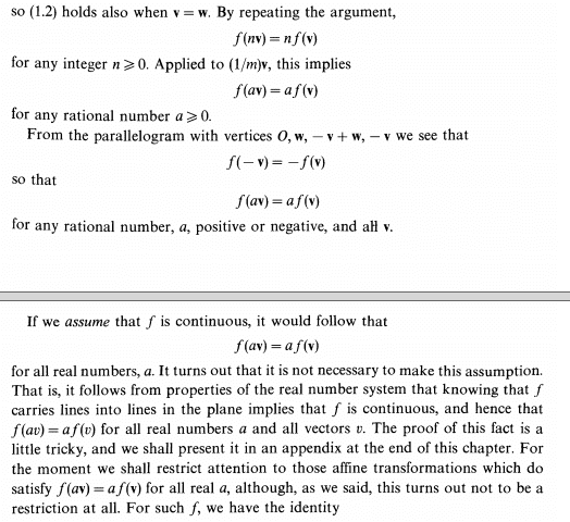

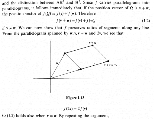

I upload the book's section I'm referring:
Figure 1.13: a parallelogram with vertices at the origin, v, w, v + w and v + v = 2v, with the edges labelled w, v and v + w, and the point 2v marked at the far right.
Scanned textbook page showing a derivation: f(nv) = nf(v) for integer n, f(av) = af(v) for rational a, f(-v) = -f(v) from a parallelogram, then assuming f is continuous to extend to all real a.
The book doens't start with the definition of Linear Trasformation, but try to deduce it.
  • Figure 1.13: a parallelogram-based diagram with vectors v, w, v + w and 2v drawn from the origin, showing f(2v) = 2f(v) on a textbook page.

  • Scanned textbook page showing a derivation: f(nv) = nf(v) for integer n, f(av) = af(v) for rational a, f(-v) = -f(v) from a parallelogram, then assuming f is continuous to extend to all real a.
Simply says that f is a one-to-one affine trasformation that keeps the origin fixed.
Before, it says that the affine trasformation is a trasformation that carries lines to lines

Well, in the section you quoted, it says "The proof of this fact is a little tricky, and we will prove it in an appendix..."

What i don't understand are the deductions done by my book, and you can see them in the 2 pictures i posted.
[tex]f(a\bar{v}) = f(\sum\bar{v})\text{(Sum it $a$ times)}[/tex].
[tex]=\sum f(\bar{v})[/tex].
[tex]=af(\bar{v})[/tex].
for every integer a.
One thing I am not able to understand is how use this demonstration in order to prove
[tex]f(a\bar{v}) =af(\bar{v})[/tex].
for every rational a.
My book does this implicitly in this image, but i don't understand what it did...
Two blocks of printed text from a linear algebra textbook: derivations of f(nv) = nf(v), f(av) = af(v) for rational a, and f(-v) = -f(v) from a parallelogram, followed by a note on assuming f is continuous to get f(av) = af(v) for real a.
  • Two blocks of printed text from a linear algebra textbook: derivations of f(nv) = nf(v), f(av) = af(v) for rational a, and f(-v) = -f(v) from a parallelogram, followed by a note on assuming f is continuous to get f(av) = af(v) for real a.
I'm not sure about the picture, either. But it seems to me that if it's true for integers, it has to be true for rationals, as well.
##f(n \cdot \frac{x}{n}) = n f(\frac{x}{n})##
Therefore, ##f(\frac{x}{n}) = \frac{1}{n} f(x)##.
##f(\frac{m}{n} \cdot x) = m f(\frac{x}{n}) = \frac{m}{n} f(x)##
