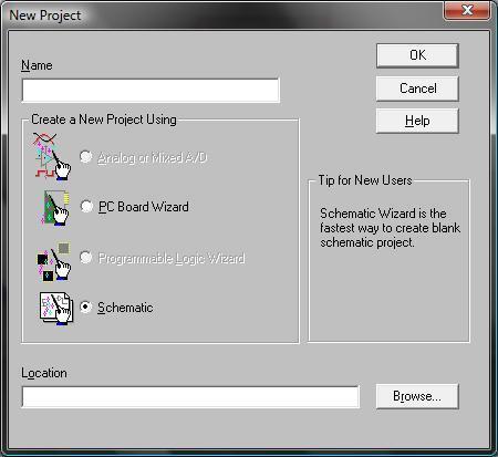

I don't know why my OrCAD Capture 9.2 hide the choices "analog and Mixed A/D" and "Programable logic wizard" when I make new project.
pspsice is now owned by orcad so fundamentally the same...
when accessing libraries, at start up, ensure you add libraries for your poject that are pspice enabled...some libraries are only for stuff like schematic, pcb etc...
the main library i use to test an idea is the breakout library...always load that one for your tests...it includes all your basic needs...
also, for ground, use the power ground that has the zero label and that will take care of any ground errors you get. normally accessed from the drop down power menu...depending on the version you have.
