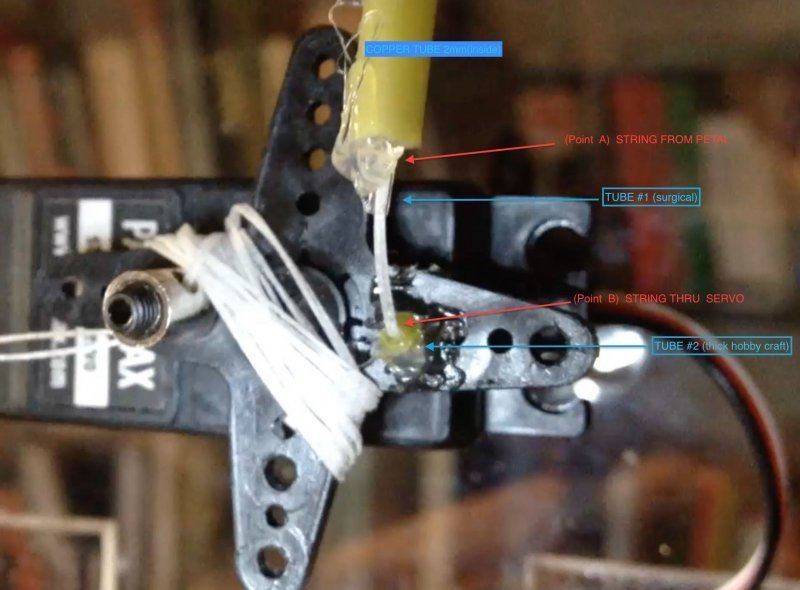

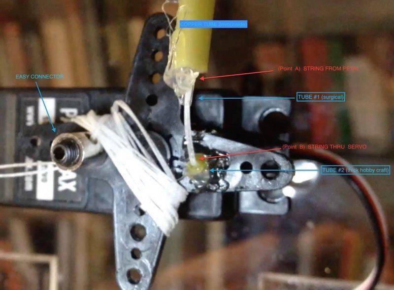

Hi all,
"MECHANICAL FLOWER PROJECT"
I'm working on a personal hobby art project (non-academic, non-commercial, non-governmental) where I'm mechanizing petals of a plastic flower. Basically, making petals curl open and close.
*Please see picture and video.
GOAL:
To pull continously without fraying or breaking the string (duration: 6-8 months or longer).
MATERIALS:
1) braided fishing line (20lbs, .24mm, Spiderwire brand, ultracast)
2) Parallax servo horn (4 pronged turning pulley)
3) Tube #1 (surgical - syringe, .5mm thick, very soft)
4) Tube #2 (thick hobby craft tube, 1mm thick, rougher)
As you see from the picture and video, I have used tubes for the two (2) 'friction' points: (POINT A) Coming out from the flower within the copper tube above; and (POINT B) as the string loops into the Servo which pulls the string.
(Note: I have not tied any knots on the servo because I was afraid of the friction at POINT B, so instead, I just looped the string around the servo a million times.)
Desperately seeking some engineering magical expertise.
Many thanks!
Chris

Hi, Fuichris.
Meaning no insult, I can't quite figure out the point of your question or the elaborateness of your setup. To start with, there's virtually no chance that 20# braided fishline is going to fray sliding through a latex tube, or a copper one (unless you leave a ragged edge). Secondly, there should be no friction at point B other than the back-and-forth flexion of the string. That would contribute to metal fatigue (marginally) in a wire, but won't affect string. Your tubing and wrapping, therefore, are extraneous. All that you need to do is bring the string back up from the back side of the servo arm hole and tie it to itself, or hot-glue it in place, or run a bolt and nut with a washer through the hole as a clamp.
From the beginning of the clip, I didn't actually see any movement of the flower (although I don't have my reading glasses on), and the servo point of connection barely moves.
Can you please be more specific about your concerns?
Hi Danger,
Appreciate the help and comments. :D
STRING POINT A: Previously, the string at point A was slanted and it rubbed on the copper tube and frayed a bit, which is why I put on that surgical tube at the exit point of the copper tube, and hot-glued it together. Sometimes the angle of the string gets moved unexpected, so I had to be proactive and protect it. I need the project to run indefinitely for 6+ months if need be without me fidgeting around it so I was putting all these fail-safes. It frayed twice previously because it was angled too much.
STRING POINT B: The yellow hobby tubing at point B was to avoid friction between the string and the servo horn. Previously, I had inserted the string through the 'easy-connector' (see pic) and screwed the string down as you mentioned, but the constant pulling and tension eventually broke the string within 24hrs (three times already). So this is also a problem. The reason for wrapping the string around like a madman is because: a) I can't knot it since I need to adjust the tension often and untying was difficult ; b) and I thought wrapping would alleviate the pressure/tension at anyone point and avoid causing it to fray/break. The pressure of the pull is constant and very strong.
I'm making a lot of uneducated assumptions in this setup so I'm hoping to get some advice :D
MAIN QUESTION: Is my setup sustainable for the long term or are there areas where the string will break somewhere in my setup?
Tks!
Okay... I'm still a bit lost, but two things that you mentioned this time (not in original) are the magnitude of the load and the need for adjustability. Those make a huge difference. I'm going to retire with my TV, beer and pizza, and ponder this some more. Right now, the only thing that comes to mind is using a turnbuckle to attach the horn and string.
I got interrupted by real life, but I'm back now. So... you're not going to like some of the things that I say, but I'm honestly trying to give you my best advice.
Point #1 is that no matter how often or how closely I look at that video, I can't see any movement whatsoever in the flower. It isn't on camera long enough. Your written explanation is lacking detail. There's a big difference between having some curling at the petal tips and having them close up like a rosebud.
I can't see where the copper tube is. In order to protect the string from scraping across its ends, you have to have your latex tubing inserted inside those ends, not just crammed on from the outside. Is that what you did? Otherwise, you're just hiding the wear-points from view.
There's no point in tossing a perfectly good servo since you already have it, but you'd have been much better off going with a crankshaft on a normal motor.
The wrapping is totally unnecessary other than to store up a lot of spare string. The stress relief that you mentioned is non-existent, since there is essentially no stress upon the string once it's through the hole and secured. For the tension adjustment, I still think that a turnbuckle would be best, unless a progressive spring would suit.
While it would be very dirty, I would recommend firing graphite powder into the tube. Since the guts are out of sight, the mess shouldn't be a problem. Just be sure not to let it get inside the servo housing or into contact with other electrical bits; it's highly conductive.
My own approach to the whole thing, if the budget allows, would be to forget the whole string thing and insert shape-memory metal wires into the petals. Whenever you apply current, they'll curl up; turn it off and they'll return to the rest state.
I'll wait for your response to this before commenting further. I might be way off-base, and don't want to continue without consultation.
It looks like solid nylon fishing line rather than braided, which doesn't make that much of a difference except flexibility on tight corners, but that is not the problem per se.
You have already seen that any sideways motion of the line against another surface will cause failure. So eliminate the contact will surfaces moving lateral with one anothe by having a clearance between the line and the part.
Cable works best in tension. Eliminate any places where there is a bending motions in operation. One such place is where the line is glued to the motor arm. Attach a wire to the end of the line, and then the wire to the arm. Danger mentioned a spring - add one somwhere to smooth out tension forces, possibly instead of the wire.Make sure the wire, or spring, at that located works smoothly with no rubbing or bending. If you have to offset by attaching to a bolt or pin through the arm, then do so.
Flexible tubing. If the line wears through then you will get binding. The flex could be for the dust bin. Sure the flexing looks like it is doing something but what really other than flexing. Pass the line through a smooth end grommet of harder material that won't wear out. Make sure your line runs always straight into the copper tube through a grommet after passing over a large radius curve would be better, if the angle of the line is excessive.
Points of summary
- no, or minimum bending of the line, except over large radius
- no sideways rubbing of the line against other surfaces
Hi Danger!
- "I can't see any movement whatsoever in the flower."
Sorry about that. Try this link, you will need to scroll through to the end of the short video:
https://player.vimeo.com/video/108456552
- "I can't see where the copper tube is."
Yes, the latex tubing is inserted inside the copper tubing.
- "wrapping string ...essentially no stress upon the string once it's through the hole and secured.."
My worry was how how it is secured through the hole of the servo horn. A knot is difficult to adjust, and putting it through the easy-connector will eventually break the string.

Can I clarify with you on your comments:
- "Eliminate any places where there is a bending motions in operation. "
Did you mean even the string going through the hole of the servo arm is bad as well? (like the way i did it?)
- "One such place is where the line is glued to the motor arm."

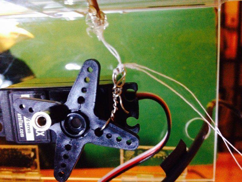

Actually, my bad, my pic is not in the best angle. It's the yellow tube that is glued to the motor arm as my way of cushioning the string thru the hole.
- "Attach a wire to the end of the line, and then the wire to the arm."
I just tried your idea of the wire + string... see pic... is this what you mean? Problems: tying a knot to the wire makes it hard for me to adjust, and I think the wire may be too soft because I noticed that if I pull hard enough, the wire will loosen? Am I doing this right? Danger's idea of a shape-memory wire is sound great at this point ;p

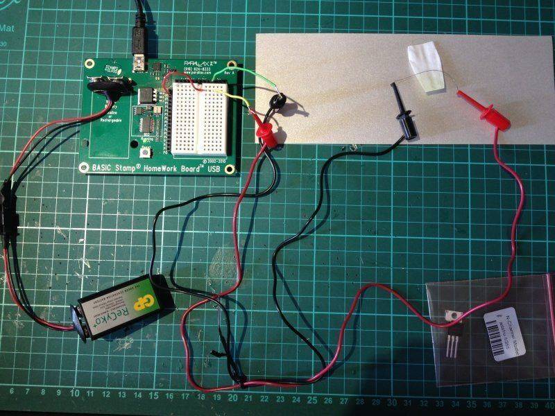

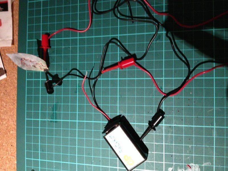

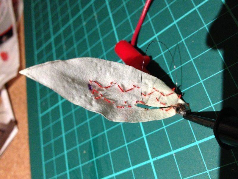

Well! My first test of the flexinol wires didn't go so well. If you know of a link to how to hook up flexinol wires to a breadboard / microcontroller, let me know ;p
Crash and burn!
Bummer! :(
Did you use the wire manufacturer's controller design, or something else? The pictures make it look as if the thing just snapped into shape instantly and ripped through the fabric rather than curling gently.
If you can't control the wire's inherent transition speed, all that I can think of is to replace your return spring with a much stronger progressive one to provide velocity moderation.
