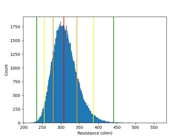

Let's take Wikipedia's Ohm's law example: ##\sigma_R \approx R \sqrt{\left(\frac{\sigma_V}{V}\right)^2 + \left( \frac{\sigma_I}{I} \right)^2}##. What is the useful information you get without plugging numbers? Is it that you expect ##\sigma_R## to grow as the relative uncertainty in the variables involved in the relation between R and those variables grows? Or... something else?

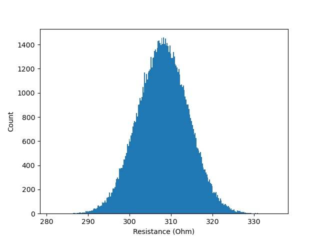

Suppose I wish to design an experiment to optimally measure this resistor.
There are random reading errors and my ammeter has a percent deviation of 10% versus 2% for my voltmeter. I can minimize these by repeated measurements, but I wish to utilize my time wisely: maybe ~100 measurements total.
I know immediately what the formula tells me to do.
How does one proceed in the world of Monte Carlo??.

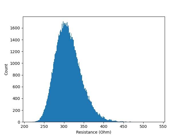

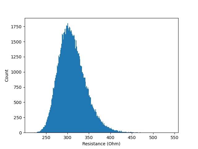

I think I am slow and I am missing something. In your case, as I understand it, the voltmeter has a 2% deviation regardless of the current used (thus voltage read)? Similarly for the ammeter, except that this is 10%. Then the formula tells me that ##\sigma_R## is fixed, regardless of the current used. Surely I am missing something, or I haven't understood your case well?
Something else the Monte Carlo gives no direct insight about.
The standard error of the mean of N measurements equals ##\frac \sigma {\sqrt N}## so you can tune error analytically to optimize the number of repeat measurements for each.
This would reguire a lot of Monte Carlo. Physicists use analytical methods because they have power, not because they are the simplest or most transparent.

I do not really understand again. For a given set of measurement(s) yielding the value of interest, Monte Carlo provides you sigma, right? In what way does this differ from the analytical formula yielding sigma? Only the computational cost?
I am attempting to design the experiment, knowing the single measurement precision of the ammeter and voltmeter. By taking multiple measurements I can produce different errors in each mean. Using the analytic formula I can figure out how to optimize the experimental procedure for a given expenditure of effort.
Such optimizations are often required in the real would with many input error sources. Repeatedly plugging guesses into a Monte Carlo simulation is not a good way to proceed.

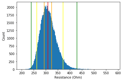

Office_shredder, I think you may have some cognitive bias against me. If you reread my first post, I am wondering why MC is not mentioned (nor taught) in standard undergraduate (physics) curriculum. I have nothing against what is taught (the mentioned analytical formula). It is only after someone stated that there is no time to cover everything that in this very restrained case I mentioned to then teach the most useful in real world (which also happens to be more intuitive to me) way to compute uncertainties, which I thought would be MC over the analytical formula. I would argue that this is as extreme as not mentioning MC (I am not even talking about teaching MC, just mentioning it).
Now hutchphd is teaching me that the analytical formula provides insights that the MC do not, it's taking time for me to see it, but does that mean I wish I had never been taught the analytical formula and used it with a button in a computer? :) Not necessarily. :)
With MC, you also get a mean and a standard deviation (same thing as the analytical formula), that's the reason why I did not see hutchphd's point at first, but now I see exactly what he meant. Thank you (and sorry for your time), hutchphd.
