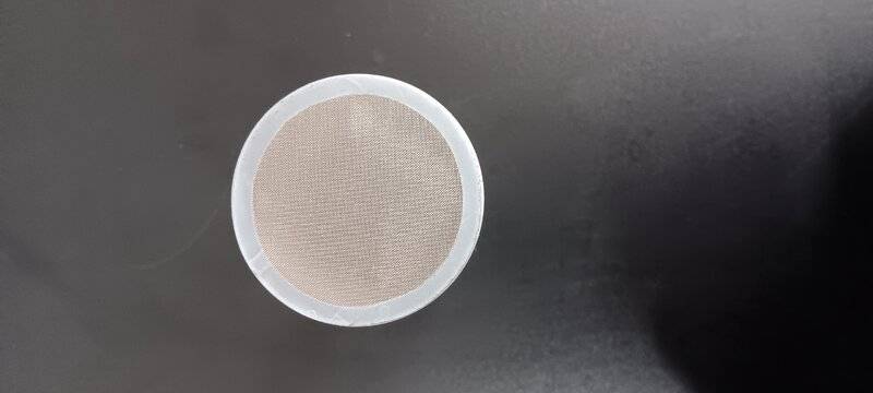

The susceptor would be a very thin stainless steel micro-mesh fabric screen (think: the inductively bonded sealing foil under a plastic pill bottles' cap bonded to the bottle top ..... but in a screen form).
The pics below shows this micro-mesh fabric screen melted into the "butt end" of a PVC pipe.
This was done with a standard electric flat iron.
This was done to contain the water filtration's TAC polymer beads fluidized within the pipe (media tank).
No primer or cements! .... creates an indestructible bond at no cost or curing time (typically 8 hours)!

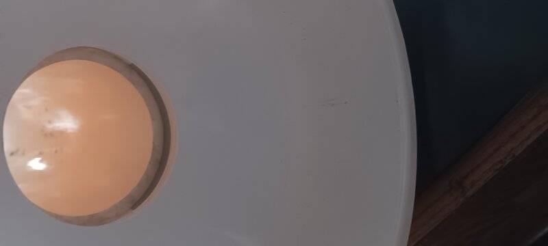

This pipe "butt end" polymer melt bonding led me to think ...... could I melt the pipe to socket connection like this as well!
The pic below now shows this "butt end", melted on screen, to its 2" PVC pipe, inserted into a 2"x 4" PVC reducing coupler.
The dark area (running from 2 o'clock to 4 o'clock) is the incerted micro-mesh screen susceptor (normally would encircle the entire O.D. of the 2" pipe ..... but shown here for contrast)

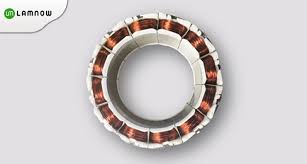

The "work coil's" design ...
The work coil is to be of a "split ring" design (because it has to place itself around the already assembled pipe and fittings)

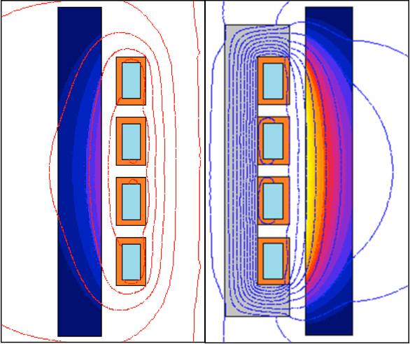

My thoughts are to make my work coil based on a segmented motor "stator" framework (see pic below)

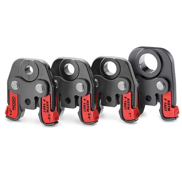

The work coil would be mounted in a plumbers "ProPress" like "Jaws" fashion, ..... opening and engaging around the PVC socket.
This portable induction heating system's circuit board would be attached to the split ring work coil frame (about the size of a pack of cigarettes)
The circuit board to be powered by a supercapacitor's discharge.
My initial question in all this ...
Instead of the typical single inductor work coil, can the design be of an equivalent "distributed" multi-inductor/multi-capacitor (mini-tank circuits) surrounding the susceptor? ie: every mini-tank circuit is of each segment on the stator.
If so, would this not keep the very high tank currents off the circuit board ...... and away from the much lower exciter current?
..... your thoughts on this?

Induction heating coils have an air core, and operate between about 10 kHz and 30 MHz.
Induction coils cannot have a magnetic core, because the core would get hotter than the wires, and would screen the item that you wanted to heat.
What is a flux concentrator? How come it does not also get hot?
In induction heating, magnetic flux concentrators, also known as flux intensifiers or controllers, are materials used to focus and intensify the magnetic field generated by the induction coil, improving efficiency and allowing for more precise heating of specific areas of a workpiece.
https://www.inductoheat.com/an-objective-assessment-of-magnetic-flux-concentrators-2/#:~:text=March 26th, 2021. Magnetic flux concentrators (also,that of magnetic cores in power transformers.
Note: The segmented stator above are coil mounted "ferrite" cores ..... not iron laminations!
It seems that a flux concentrator is actually a partial external magnetic core, designed to reduce interactions between multiple induction coils by screening.
Go ahead, design your coil geometry, include the flux concentrators, but don't expect to heat the thin wires, that are relatively far away on the other side of the PVC.

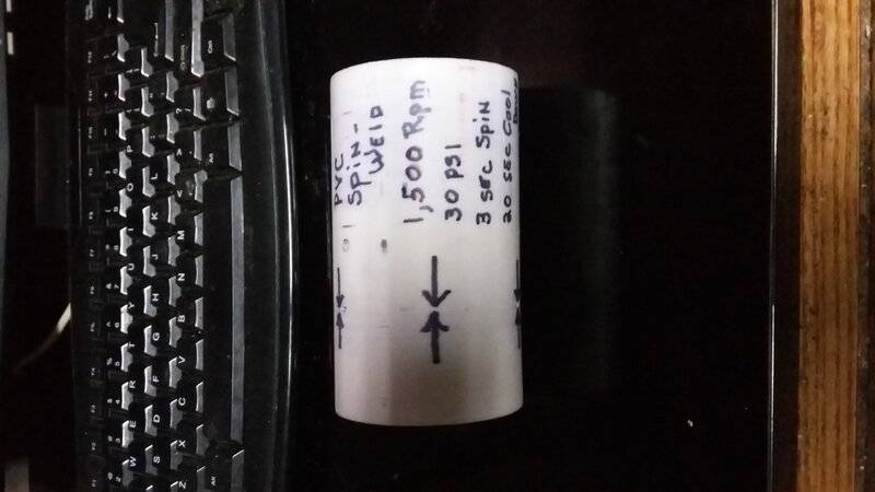

In my PVC "spin weld" prototype below .... the interfacial heating is largely restricted to just the immediate surfaces.
Its all done in less than 3/4 seconds!
(the joint is in between the arrows!)

In the above pic,
See the raised circular rings at the top of the pic? .... there would reside the "work coil tanks" (multiple tank inductors and capacitors) within that raised area only.
Notice that the rings are "split" (think: spring loaded hinged wooden clothes pin to open the "jaws" around the pipe)
