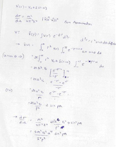

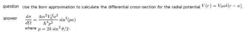

Hi, I get an a^4 whilst the answer has an a^2. Where am i going wrong? Is the delta function throwing a spanner in my work?
see attachments for question/equations and my attempt.
Thanks
  • Text showing a question to use the Born approximation for the differential cross-section with radial potential V(r) = V0 a delta(r - a), and an answer dσ/dΩ = 4m^2 V0^2 a^2 / (ħ^4 p^2) sin^2(pa), where p = 2k sin^2 θ/2.

  • Handwritten Born approximation derivation for a delta-shell potential V(r) = V0 a delta(r-a), taking the Fourier transform in spherical coordinates and arriving at the differential cross-section d sigma/d omega = 4 m^2 V0^2 a^4 sin^2(pa)/(hbar^4 p^2).

I think your calculation is correct with the a^4. If you check the units in your answer (with p having units of distance^-1.. since it should really be k instead of p), you correctly get units of area. The whole calculation looks ok to me.
