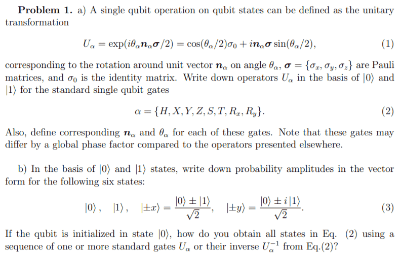

a) A single qubit operation on qubit states can be defined as the unitary
transformation
U_α = exp(i*θ_α*n_α*σ/2) = cos(θ_α/2)σ_0 + i*n_α*σ *sin(θ_α/2), (1)
corresponding to the rotation around unit vector n_α on angle θ_α, σ = {σ_x, σ_y, σ_z} are Pauli
matrices, and σ_0 is the identity matrix. Write down operators U_α in the basis of |0 > and
|1> for the standard single qubit gates
α = {H, X, Y, Z, S, T, Rx, Ry}. (2)
Also, define corresponding n_α and θ_α for each of these gates. Note that these gates may
differ by a global phase factor compared to the operators presented elsewhere.
b) In the basis of |0> and |1> states, write down probability amplitudes in the vector
form for the following six states:
|0>, |1>, |±x> =(|0> ± |1>)/√2, |±y> =(|0> ± i|1>)/√2. (3)
If the qubit is initialized in state |0>, how do you obtain all states in Eq. (2) using a
sequence of one or more standard gates U_α or their inverse from Eq.(2)?
