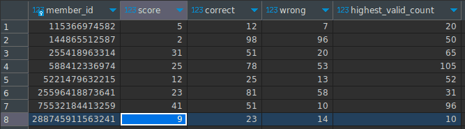

I have a database that looks like this:
I want to get the "leaderboard position" of a particular member. The idea is to order the data by the score column, and then retrieve the row position of that particular member id. This is my query in MySQL:

Any idea why I am facing this?
In case anyone wants to test, this is the code for the dummy database:

Technology news on Phys.org
Could be all sorts of reasons why it doesn't work, but a robust (and probably more efficient) way to do this is to use two queries, one to get the member's score and another to COUNT the number of rows with a higher (or higher-or-equal) score.
