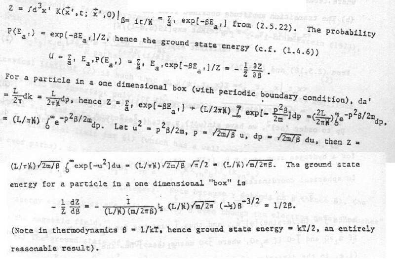

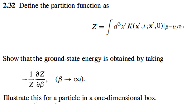

Hello!
I am studying the Sakurai book on Quantum mechanics and I am doing a problem. I have the solutions to the problems to help me understand the material better but I do not understand this solution.
SEE "Sakurai Problem 1" in attachments
K is the propagator in wave mechanics.
2. Solution
There are a few parts of this solution that I do not understand.
1.) In the first part it states that "The probability is.."
[tex]P(Ea')=exp(-βEa')/Z[/tex]
Probability of what? It doesn't actually tell me what the "Partition function" is or means. Isn't the propagator an operator? I thought in order to have a probability you need to have a state in mind.
2.) I also do not understand why the ground state energy is equal to that summation "U=..." in the next line.
3.) I do not understand the first change of variables in the differential, da' = L/2π dk
If anyone could help me understand this, it would be much appreciated! :D

If beta were an inverse temperature, P would be the probability to find E_a' in a canonical ensemble.
The precise probability interpretation does not matter too much, as all you want to show is that the limit on beta gives you the ground state energy.
No, the propagator isn't an operator but a matrix element of the the time evolution operator between states <x',t'| and |x,0>.
If you will see the text,you will find that space integral of propagator with x''=x' in K(x'',t;x',t0) will give you G(t)=Ʃa'exp(-iEa't/h-).This is just the trace of time evolution operator and is independent of representation.Now you have to identify β=it/h-(with t imaginary),and you will identify it as partition function.

I still do not seem to understand. How do they actually obtain the expression for probability? I don't understand the reasoning behind it.
I didn't even know what a partition function was until I just looked it up. I never took statistical mechanics. :\
