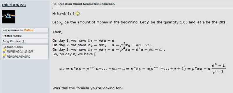

Hi hawk 1sr! :smile:
Let x0 be the amount of money in the beginning. Let [itex]\rho[/itex] be the quantity 1.05 and let a be the 20$.
Then,
On day 1, we have [itex]x_1=\rho x_0-a[/itex]
On day 2, we have [itex]x_2=\rho x_1-a=\rho^2x_0-\rho a-a[/itex].
On day 3, we have [itex]x_3=\rho x_2-a=\rho^3x_0-\rho^2a-\rho a-a[/itex].
So, on day n, we have [
[tex]x_n=\rho^nx_0-\rho^{n-1}a-...-\rho a-a=\rho^nx_0-a(\rho^{n-1}+...+\rho+1)=\rho^nx_0-a\frac{\rho^n-1}{\rho-1}[/tex]
Was this the formula you're looking for?

I think the LaTeX images has not loaded for you, here is the image:
