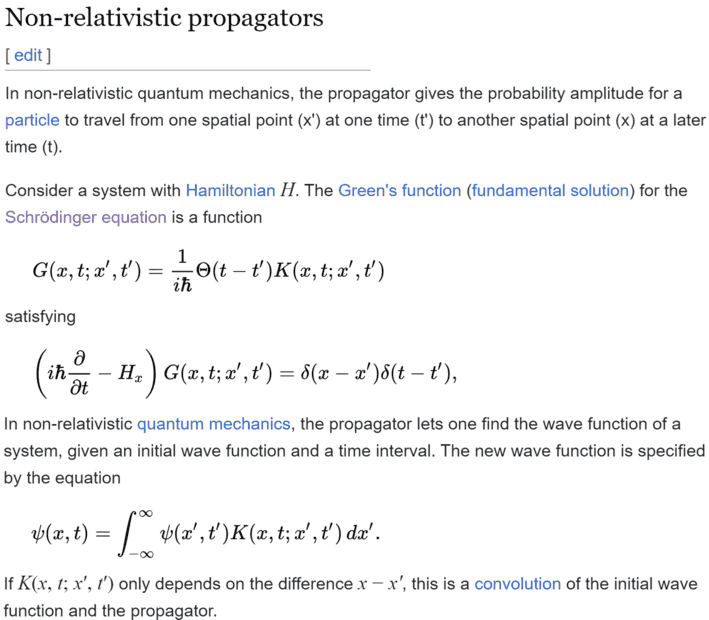

Yes, in ordinary QM the propagator is the amplitude you describe and it's used to evolve the ordinary wave function ##\psi##. See, e.g., https://en.wikipedia.org/wiki/Propagator:
I know the interpretation in normal QM does this interpretation still hold in QFT thats my question. Do Relativistic Propagators really describe particle propagation
