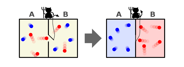

So if we have a 1900C gas reservoir, the photovoltaic device is generating some current from the radiation off the walls of that reservoir, the current heats a filament above 2000C, and the more than 2000C filament heats a small amount of gas to approximately 2000C… isn’t that working similarly in principle to a “Maxwell’s Demon?” In the end the hot reservoir gets hotter essentially by cooling the cold reservoir, correct?
https://en.m.wikipedia.org/wiki/Maxwell's_demon
Wiki: “Maxwell's demon is a thought experiment that would hypothetically violate the second law of thermodynamics.
“…the demon's actions cause one chamber to warm up and the other to cool down.
I see no relationship whatsoever to Maxwell's Demon. Please post a diagram that shows exactly what your system/setup is, not just a diagram of something else that isn't it but may or may not be similar.
I'm near certain I know what you want to do here, and it doesn't work/would be a violation, but I'm not guessing. Out with it!
