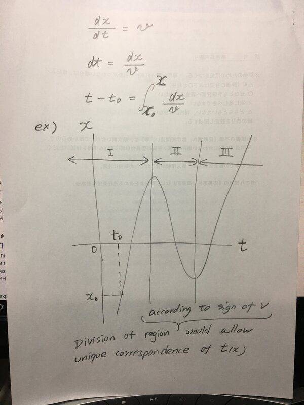

SchroedingersLion said:
How can you tell?
We can divide the region in order to keep unique correspondence.

Thanks for the drawing, I understand!
