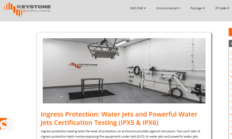

In my work I am always having to assess products for how they perform outdoors
One of the tests that we make is Ingress protection IPX6 for water jets
The test is made using a large hose, with water flowing at 100 liters per minute (or 15psi)
The test unit is 3 meters from the nozzle of the hose.
What I would like to know is what is the force acting upon the test product when the water is hitting it?

Your testing is like this, right?
https://keystonecompliance.com/ipx5-ipx6-water-jets/

Looking at the summary from the link in my post #5, it looks like the test defines the pressure at the target, not back at the nozzle, no?
IPX6 Powerful Water Jet Testing:
Defined as water projected by a nozzle (12.5mm).
The requirement is that the equipment under test (EUT), shall experience no harmful effects from the water being sprayed against the enclosure from any direction.
The test details include a test duration of at least three minutes, water volume of 100 liters per minute and pressure of 100 kN/m² at distance of three meters.
EDIT -- Although, their wording is a bit ambiguous as to whether that water pressure is at the device which is 3m from the hose nozzle, or back at the nozzle 3m away from the device... Do you have access to the full test spec?
