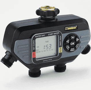

You can get watering timers. I had one to water my yard during the cooler parts of the day, when it wasn't prone to evaporation.
You can get a single zone timer or a multi-zone timer.
The advantage of a multi-zone timer - which may or may not prove useful to you - is you can parcel out your watering over time to maximize pressure. There's an upper limit to the length of a soaker hose system, when the pressure drop so low that it stops becoming effective.
My yard was too big to do all at once. So I ran more than one hose to different parts of my property, and then set the timer to run one for 30 minute sthen the other for 30 minutes. That way, each gets the benefit of full pressure.
Multi-zone timers can vary from two to four 'zones' and the prices range accordingly.
If you are concerned about the cost, consider the financial cost of running too much water or too little or the wrong time of day when it will just evaporate. It will never forget, or get ill or go on vacation. And on hot, dry days, you just hit a button to "add 10 minutes" for an extra soak. Or skip watering on rainy days. Factoring in these things makes the timer pay for itself.

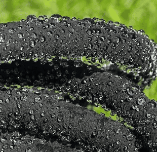

Look up "soaker hose" or "weeping hose" on any garden supply place.
Some micro waters system are very complex, but a soaker hose is just a simple hose made of a porous skin that just leaks water along its whole length, like this:
It would be ideal for your hedge.
The advantage to a soaker hose, BTW, is that it doesn't spray all your precious water into the wind where it will be carried away or evaporate. It drips it straight onto the ground. This also means you need to water less, as a larger percentage of the water is actually getting directly to your hedge's roots.
You can cut or clamp it to the exact length you need (which sounds like you'll need two 50' rolls), and you can even bend it around a between your hedge trunks to hold it in place (or use the U-shaped spikes).

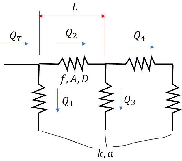

I solved the following system with 3 holes analytically:
Where
##Q_i## are a particular segment volumetric flowrate.
##k## is the hole loss coefficient in each branch (currently the same across all holes)
##a## hole cross sectional area
##f## is the mains friction factor from Moody Diagram (approximated as constant for the time) .
##A## is the mains cross sectional area
##D## the mains diameter
I mostly just wanted to try this Desmos link:
So when there are three 1mm holes across the 30 m length the flow rates are anticipated to be quite even. As for generalizing to ##n## outlets, I'll maybe have a go at 4 outlets analytically - the way it shook out for I could be looking for a pattern to emerge.

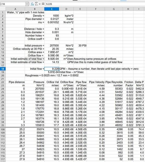

I had some free time, so spent about two hours creating a spreadsheet to calculate this problem. I used an iterative method to solve.
The method is as follows:
1) Start with a supply pressure and an estimated total flow.
2) Calculate the pressure drop for the first 30 cm of pipe.
3) Subtract from the initial pressure to get the pressure at the first orifice.
4) Use Bernoulli to calculate velocity from the first orifice.
5) Calculate orifice flow from orifice diameter, orifice coefficient, and velocity.
6) Subtract orifice flow from from entering pipe flow to get pipe flow after the orifice.
7) From pipe flow, calculate pipe velocity and pipe Reynolds number.
8) Look up friction factor from Moody chart.
9) Calculate pipe pressure drop for next length of pipe.
10) Repeat until reach the end of the pipe.
11) Iterate the initial flow until the pipe velocity after the last orifice is zero.
A screenshot of the spreadsheet is shown below. Somebody taking a close look will notice room for improvement on the friction factors. The solution is not sensitive to friction factors at lower pipe flow rates, so I cut some corners there. This was a quick effort, and not fully cross checked, so I might be off on the exact number of orifices. Or some other error.

The above calculation assumes that the water supply will deliver 9.2 GPM at 30 PSI. Since the OP mentions 30 LPM (8 GPM), apparently at free flow, the actual pressure and flow rate will be less. So I dropped the inlet pressure to 10 PSI. The resulting total flow was 5.3 GPM. In both cases, the flow from the last orifice is 52% of the flow from the first orifice.
The water velocity from the orifices is enough to cause erosion. The pipe should be oriented so the water jets point straight down into the ground without hitting the plant roots.

Since the spread sheet is set up, would it be too much trouble to check it against the analytical result for 3 holes I shared?
