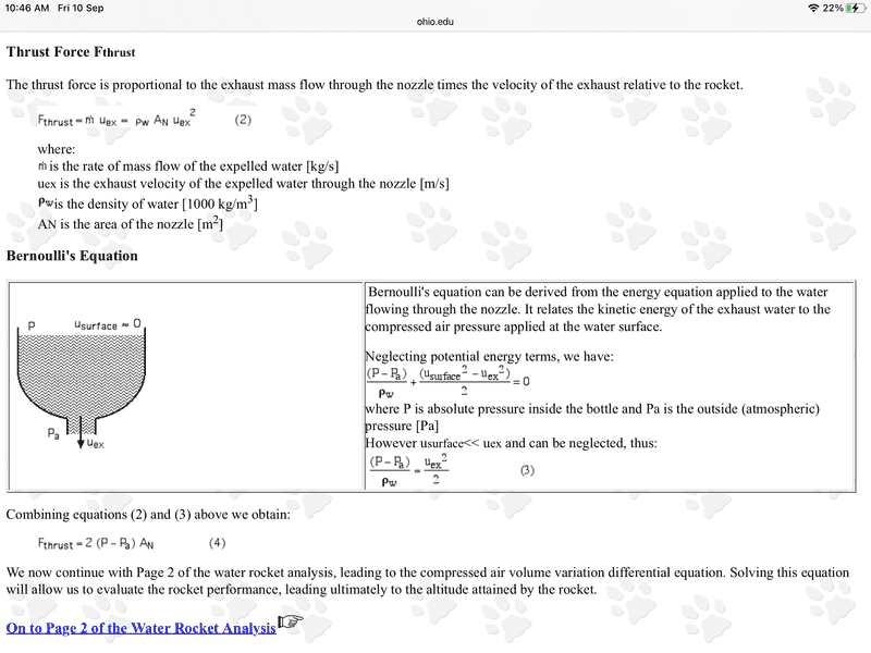

Well known examples of the force produced by pressurized water exiting a pipe:
JetLev Water Propeled jet Pack.
Hovering Car.

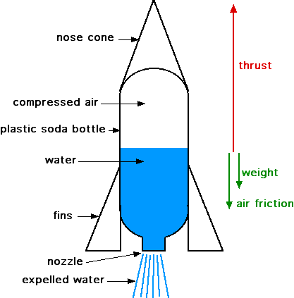

I need to calculate the maximum for the thrust produced when the hose or pipe is bent rearward.
Since this is similar to the case of a water bottle rocket, the guess is it should be the same as that case:
The thrust force is:
F = 2*(P - P₀)*An,
Where P is the pressure in the pipe, P₀ is the ambient air pressure, and An is the area of the nozzle.
https://www.ohio.edu/mechanical/thermo/property_tables/gas/adiabatic/rocket/rocket.html
Note the extra factor of 2 there. An odd aspect of this formula is that it would appear that you could just increase the thrust by making the nozzle size larger.
However, note in the derivation you need the cross-sectional area to be small enough on exit so that, by the Bernoulli principle, the exit velocity would be large. So making the exit area larger would obviate the argument used.

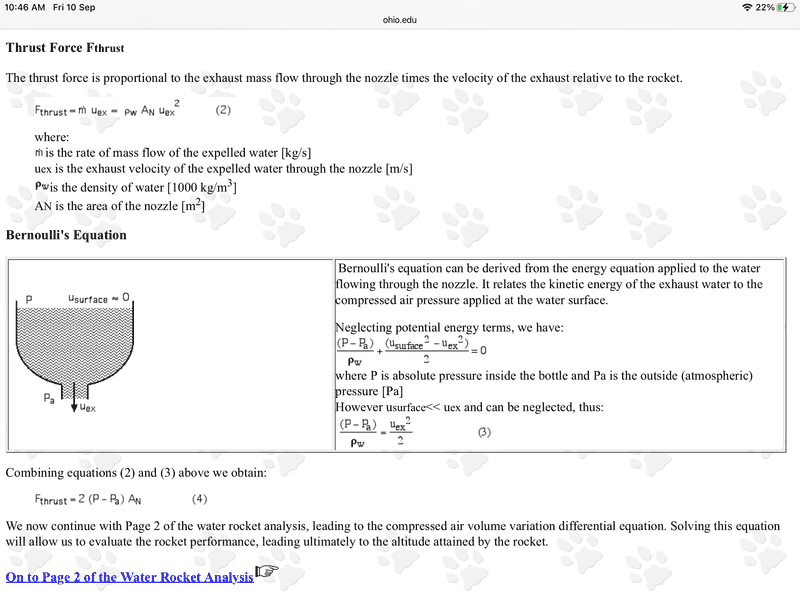

Here is the water bottle rocket analysis:
We’ll use the first equation shown there which amounts to F = (mass flow rate)*(exit velocity). Take for example this pressure washer:
PowerShot PS4240 4200 PSI at 4.0 GPM Cold Water Gas Pressure Washer with HONDA GX390.
https://www.homedepot.com/p/SIMPSON...her-with-HONDA-GX390-49-State-60456/203448619
It can do 4,200 PSI at 4 GPM with a hose at 3/8 inch inner diameter. We’ll convert to metric to have consistent units. A gallon is 3.78 liters so 4 GPM, is 15.12 liters per minute which for water means 15.12 kg per minute or 0.25 kg/s.
For the exit speed, we’ll use the last formula given there,
(P - Pa)/ρw = uex2/2.
Now 4,200 is 4,200/14.7 = 286 bar = 286E5 Pascals.
Then uex2 = 2*286E5/1000 = 57,000, and uex = 240 m/s.
So the force would be 0.25 * 240 = 60 N, or 6 kg-force, about 12 pounds.

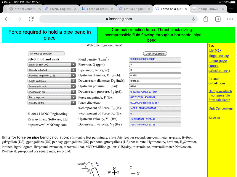

On the other hand, let’s see what the answer would be using the online calculator. Here we will not restrict the area like in the water bottle case. So the diameter will be 3/8” = 9.53E-3 m. We need to divide volume for rate of 0.25 liters per second by the area cross section to get the speed. This results in a speed of 3.5 m/s.
Plugging the numbers into the calculator here:
https://www.engineeringtoolbox.com/forces-pipe-bends-d_968.html
results in a force of 915 pounds!

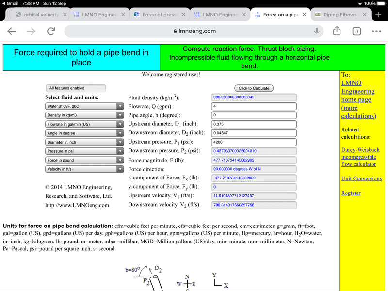

So I finally broke down and paid for the for-pay online calculator at the link:
https://www.lmnoeng.com/Force/ForceBend.php
I was surprised to see when I did put in the restricted diameter hose dimension after the bend that the force was still much higher than the water bottle rocket case:
The force calculates out to be 477 pounds! This compared to the ca. 12 pounds you get from the water bottle rocket analysis.
Note the exit gauge pressure is approx. 0, i.e., relative to that of ambient air, and the flow speed is greatly increased. This now is a real discrepancy.
So which is the right answer?

Robert Clark
Well, then something isn't quite right, or we are missing something in the design. Maybe the 4 gpm is too low. We would have to get a look at the internal piping of the washer before being able to resolve this.
What is actually unreasonable?
After examining some photos of power washer nozzles (with water jetting out) on the internet, a more clearcut picture is emerging. For a 0 degree nozzle (leading to maximum stagnation pressure), the jet diameter appears much smaller than I imagined. Your estimate of a 0.0455" diameter for the nozzle jet seems more realistic now. So in that case, we would have: $$A_1=0.7126\ cm^2$$$$A_2=0.0105\ cm^2$$$$v_1=3.54\ m/s$$and$$v_2=240\ m/s$$Based on this, the upstream pressure would be $$P_1=288\ bars=4180 psi $$ This would give a value of F = -448 lb for the. horzontal force of the nozzle on the fluid, and a force of +448 lb exerted by the flowing fluid on the nozzle (in the same direction as the fluid flow). This would also be the tension in the 3/8" tubing.
If there were a 90 degree vertical elbow in the 3/8" tubing upstream of the nozzle, say coming from a water reservoir, the horizontal force exerted by the elbow on the flowing fluid would be given by: $$-P_1A_1+F_x=\rho v_1^2A_1$$This gives a value of $$F_x=462\ lb$$ So the horizontal force that the fluid exerts on the elbow is 462 lb in the direction opposite to the flow. So the net horizontal force exerted by the flowing fluid on the combination of nozzle and elbow (and thus, on the internal tubing as a whole) is $$F_{net}=462-448=14\ lb$$This is also equal to just $$F_{net}=\rho v_2^2A_2=14\ lb$$This is the horizontal reaction force on the power washer. So, because of the presence of a nozzle and an elbow in the tubing, the tension in the tubing is about 450 lb, but, because of the change in direction afforded by the 90 degree elbow, the net horizontal reaction force on the power washer is only 14 lb.
