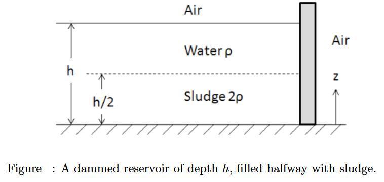

I haven't taken physics in a while, and most of this is physics related. My professor's lectures have not helped me understand the material, so I have questions on my homework. I would like to learn how to approach this problem and solve it.
The figure shows a vertical dam holding back a reservoir of depth h. The lower half of the reservoir consists of a sludge whose density is twice that of water, and the upper half of the reservoir's volume consists of pure water.
a. Determine how pressure depends on altitude z in the water and sludge.
b. Let w be the dam's width, and determine the horizontal component of force on the dam.
Thank you in advance.

a. The pressure is basically the weight of the fluid above (per area). :smile:
b. Pressure = force per area, so the force on the dam is the integral of pressure times area. :wink:
for part a, what am I supposed to do with vector z? will I have to deal with an integral?
No, you'd only need an integral if the density was varying continuously
but here, it's constant to a certain height, and then a different constant, so you can just multiply instead of integrating. :smile:

Since the pressure varies with depth there will be a different force on the dam at different depths. So integration would be needed.

Not for part a. :wink:
