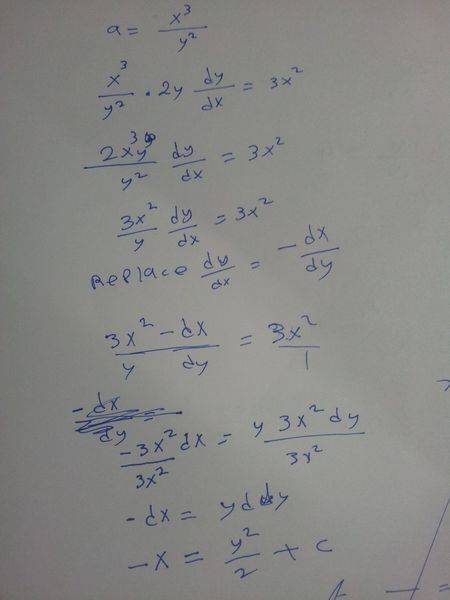

The discussion centers on the calculation of orthogonal trajectories for the family of curves defined by the equation g(x, y) = x³/y² = a. The user presents the differential equation 2ay/dx = 3x² and seeks validation of their answer. The correct approach involves calculating the gradients ∇f and ∇g, where ∇g = (3x²/y², -2x³/y³) and ∇f = (1, 2y). The condition for orthogonality is established by ensuring that ∇f.∇g = 0, leading to the equation 3x²/y² - 4x³/y² = 0.
