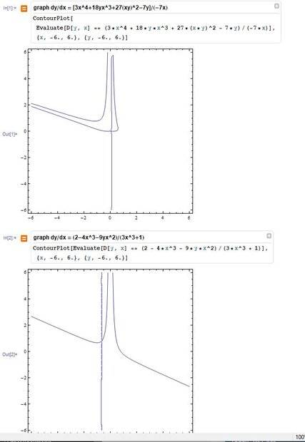

Not sure how to put them in a spreadsheet, but I did graph them in Mathematica, and got the images below.
It's interesting, as they have quite a bit of similarity, but then you have the far left curve of the top graph reflected across the y-axis in the bottom graph, and the lower arm of it shifted downward to have a similar slope as its counterpart. So similar slopes, similar values, but one of them is reflected across y with the same slope.
Can anyone tell me how to discern which one is the accurate one, and which one is not, or are both accurate, but in a different way? This is definitely a learning experience, but I don't know how to interpret the conflicting data based on different methods?

What about graphing the derivative as a function of ##x##, as in post #15 above?

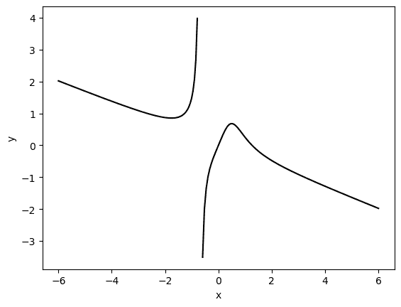

Just to put it in here: This is the graph of ##y(x)##:
The value of the different expressions for ##y'## anywhere except on this curve is irrelevant. Only the value of ##y'## on this curve matters.
Is the issue that I'm graphing dy/dx, but only specific values of x in relation to y will be relevant, and the values must be plugged into the original equation to determine what values are valid? I could be wrong on this, but I'm trying to figure it out
Yes!
This is what we have been saying since post #7:

@PeroK even gave you the explicit function ##y(x)## here. I graphed it in post #20. These are the only permissible values of ##y##. What ##y’## is as a function of ##x## and ##y## anywhere else does not matter.
Post #20:
Orodruin said:
The value of the different expressions for y′ anywhere except on this curve is irrelevant. Only the value of y′ on this curve matters.
