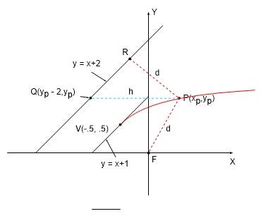

Can't leave the easiest method to die on the vine here :smile: . From the given we know the focus is at ##(0,0)## and the vertex is at ##(-\frac 1 2,\frac 1 2)##. It follows that the directrix is ##y = x+2## from the geometry. Here's a picture with a couple of additions I will explain below:
If ##P(x_p,y_p)## is a point on the parabola, its distances ##d## from the directrix and focus are the same. Distance from the focus is ##d=\sqrt{x_p^2+y_p^2}##. Distance from the directrix is the leg of the ##45^\circ 45^\circ 90^\circ## triangle ##PQR## with hypotenuse ##h = x_p - (y_p-2)## (the blue line). So ##d =\frac{x_p-y_p+2}{\sqrt 2}##. Square these two expressions for ##d##, set them equal, and drop the ##p## subscripts, and you have your equation.

LCKurtz said:
vertex is at ##(−1/2,1/2)##
How did you conclude that the vertex is at that point?
That's the point of the tangent of the vertex closest to the focus.
I'm not sure I understand
Draw any parabola on a piece of paper and the tangent line at its vertex. The focus is on the axis of the parabola and the closest point on the tangent line to the focus is the vertex. Also the axis of the parabola and the tangent line are perpendicular at that point.
