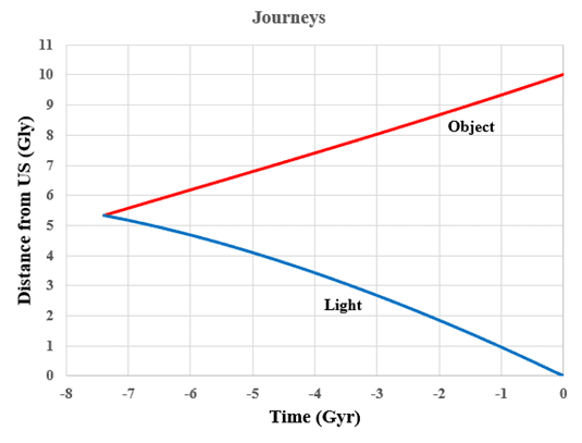

JimJCW said:
  1. Suppose we receive light from an object that is 10 Gly away. We want to know when the received light was emitted and the distance of the object from us at that time.
Answer to Question #1:
The light was emitted 7.39 Gyr ago at a distance of 5.34 Gly from us at that time. It takes the light 7.39 Gyr to reach us. Now the emitter is at a distance of 10 Gly from us.​
Using Jorrie’s calculator, we can obtain the following result about the journeys of the object and the light after they separated 7.39 Gyr ago at a distance of 5.34 Gly from us: the light propagating to us and the object moving with space expansion to its current location.
Line graph titled Journeys plotting distance from US (Gly) against time (Gyr), from -8 to 0. A red line labelled Object rises from about 5.3 Gly at -7.4 Gyr to 10 Gly at 0. A blue curve labelled Light falls from the same starting point to 0 Gly at 0 Gyr.
