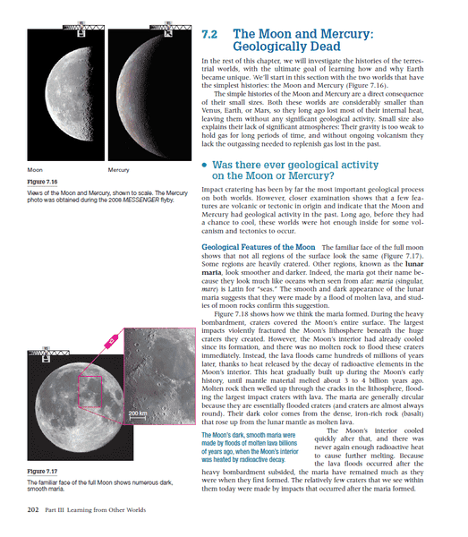

The book does contain a picture I attached of the mare which the prof. talked about but it doesn't seem to help very much

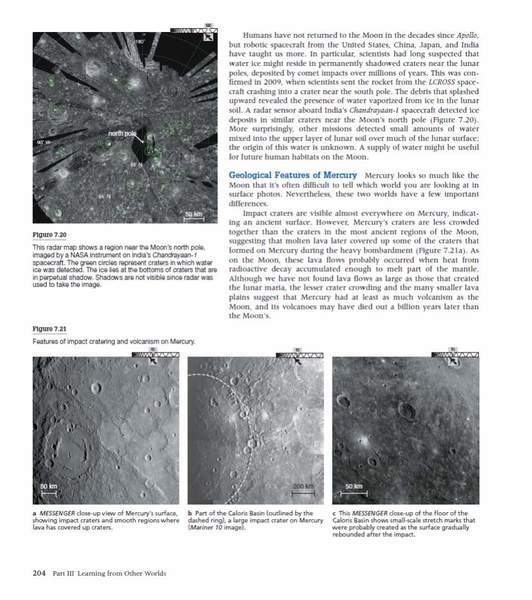

As you say, the pictures and text you posted don't help. If it's only a couple of pages, can you post the entire text? Are you sure there are no other mentions in the book?

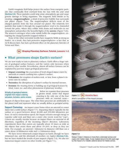

Ok, I posted 3 pictures I took from the section of the book that talks about craters and Mare Humorum (3 pages in total), but, while looking further, I found another section that talked about impacts (I posted a picture of a page called "page from different section" so you can take a look) and it says near the bottom of the page "that craters are typically about 10 times as wide as the objects that create them", meaning that if I have the diameter of the mare, I can very simply find the diameter of the object that hit it by dividing the diameter of the mare by 10, is it really this simple? I looked up the diameter of the mare and found it to be ≈ 400 km wide, meaning that the diameter of the object that hit it is 40 km wide, and the closest answer I have is 30 km (from the choices I'm given). I'm not entirely sure if this is close enough, especially when the rest of the choices I'm given for the answer are 100, 300, 600, and 1000 km which are obviously much bigger than the answer I got

Remon said:
I found another section that talked about impacts and it says near the bottom of the page "that craters are typically about 10 times as wide as the objects that create them", meaning that if I have the diameter of the mare, I can very simply find the diameter of the object that hit it by dividing the diameter of the mare by 10, is it really this simple?
It's that simple. Well, almost that simple. Look at your image of the mare. The mare is a bit bigger than the crater. Divide by 10 and then reduce it a bit to account for this apparent fact.
Hmm... that actually makes sense because the crater can't be the exact same size as the impact and then my answer would be closer to 30 km. Thank you :-p

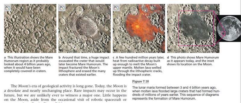

One of the images is a reconstruction of the original crater, so Remon can just use that.
Yeah but there's no scale on it or any information to tell me how wide it is, so the picture doesn't help much, but I looked up its diameter (which was about 400 km) so now its all good :)
