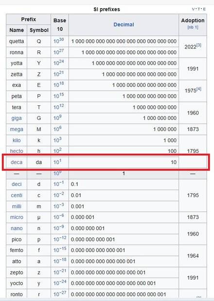

What is the meaning of "dag"?
It is either a dekagram or, in Australia, dirty, wet wool besmirching the back end of a sheep; but neither is a weight.
Donning my Googles for a moment, it seems 'a "dag" is the abbreviation for dekagram, a unit of mass in the metric system, equivalent to 10 grams'.
A 40dag box would mass 400g, and weigh 400g on Earth.
Wow, that's interesting. In Poland we use dags in shops, buying cold cuts or cheese, so everyone knows this unit from an early age, probably first unit one learns (along with km/h). Daily reminder that different parts of the world are, well, different :oldbiggrin:
