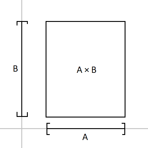

I am trying to wrap my head around what you are saying. To this end, I tried drawing a picture of what you are describing.
Here is a Cartesian product of two compact sets in two-dimensional Euclidean space.

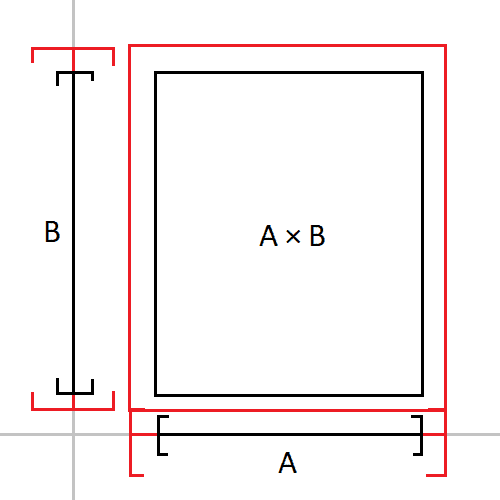

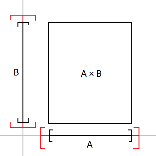

Then I drew two members of the open covers for both ##A## and ##B##. I assumed that these two open covers cover the whole line containing their respective sets. I drew only the two members of the covers that are supersets of ##A## and ##B##, for simplicity's sake. They are colored red.
And then I drew the Cartesian product of these two members of the open cover:
You said that the red rectangle was not going to be part of the original open cover, which by previous assumption:
"I assumed that these two open covers cover the whole line containing their respective sets."
...cover the whole two-space. I cannot quite understand what you mean when you say that the Cartesian product may not be a part of the original open cover. I assume you mean part of the original open cover of the rectangle.
Come to think of it, though, the Cartesian product of two open covers comprise only one class of open covers of a closed rectangle. That is to say, you can cover the rectangle with not just open rectangles, but infinitely more types of sets in two-space. For example, you can cover it with a combination of open circles, open triangles, or some crazy shapes that don't contain their borders.
The definition of compact was roughly this, I think: "If ##A \times B## is compact, then for all open covers of ##A \times B##, there exists a finite subcover that covers ##A \times B##." If an open cover of the rectangle consists entirely of the Cartesian product of two open covers, then my opening post states that this contains a finite subcover.
My guess is that you are saying that the Cartesian product of two finite subcovers, which would just be an open rectangle containing the closed rectangle, may not be contained inside an arbitrary open cover of the rectangle, which may not necessarily be a single open rectangle. I drew an arbitrary open cover of the rectangle in purple below.

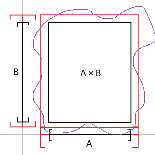

One issue to consider is that not all product open sets are of the form ##U_a \times U_b ; U_a \in \tau _A, U_b \in \tau_B ##. These are just a basis for the product topology. There is no easy way I am aware of of characterizing the open sets of the product topology.

Nice trivia: Examples of sets open in ## \mathbb R^2 ## product topology that are not of the form:
##U_a \times U_b ; U_a \in \tau_A ; U_b \in \tau_B:
\{(x,y): x \neq y \} , \{(x,y): x^2+y^2 >1 \} ##
