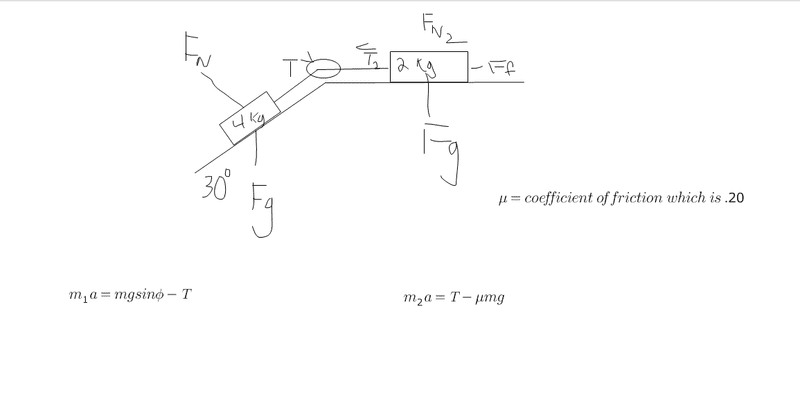

flawlessbrown
refer to 1.
The answer is 9.1 I've done everything from adding the two equations, to plugging in values I am completely stuck. I can find the tension if i solve for acceleration first. But without knowing the acceleration how do you find tension?
Isn't the acceleration the same for both blocks, so by rearranging the equations to eliminate a you could find T?
Also, is the coefficient of friction intentionally only to be applied to the block on the right?
yes i should've mentioned that
The coefficient only applies to the right block.
Well i know how to do find T if i find a first. But i was wondering if there was a way to find T before finding a.
Show us the major steps you took to do that: 'find a first'.
