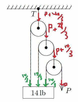

The pull P is just sufficient to keep the 14-N block and the weightless pulleys in equilibrium
as shown. The magnitude T of the tension force of the upper cable is:
Answer is 16 N.

2. I'm having a bit of trouble setting up a free-body diagram for this one, but I do know that pulleys reduce the required pulling force by a factor of 2, and since there are three pulleys it reduces the pulling force by a factor of 8. 14/8 is 1.75, which using T=mg+P equals 15.75N for T, or 16 N. Is this logic even correct? And if so, could someone help me set up the FBD so I can prove my logic?
Just work your way through each pulley, starting with the one at the bottom. If the tension in that pulley's rope is P, what must be the tension in the rope above it? And so on. Then you can solve for P and use it to answer the question. (Draw free body diagrams for each pulley and for the block.)

I'm not sure if I got it. P+42/3=14N, thus P=2. T=14+P=16N, which is right, but then the top string has two different tensions. What did I do wrong?
I think as the pulleys are considered friction-less the tension in the string over it will remains same everywhere. If it is P on the right side part of the string it will be P on the left side as well. If we consider equilibrium of lowest mass less pulley, what should be the tension in the string over the middle pulley? (tensions in the three strings will not be same)
For one thing, you seem to have assumed that the three ropes attached to the block have the same tension. Do not assume any such thing.
Start with the bottom pulley. Since the tension is P, the rightmost rope attached to the block must have tension P. Then keep going until you've analyzed all the pulleys and the block.
Hm, well if that's the case, then the tension in the string over the middle pulley is 2P, and the tension in the string over the top pulley is 4P. So together the tensions equal 4P+2P+P=7P, which has to balance out the 14N weight. So P=2. And since the tension in the top string equals 14+P, the tension is 16N?
You got it! :approve:
I would say that the tension in the top string must equal 8P = 16N, since the string through the top pulley has a tension of 4P.
