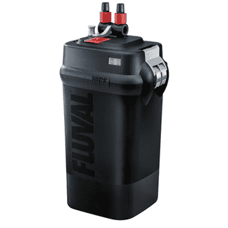

You can buy water pumps for aquaria (see image), and they are pretty silent - but that won't solve your problem. Every time it drains the holding basin (and it will) the pump will lose prime and will have to be shut off, refilled and reprimed.
That's why you're sort of stuck with a sump pump. They shut off and are self-priming.

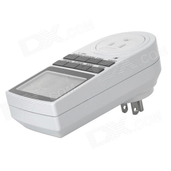

@ Dave C - what if i used some kind of timer that would run it for say 5 min and then shut off for 10 min?

Does anyone know much about electrical timers? Is there one that is reliable and can be programmed to turn on for 10 min and then shut off? Is it better to get the ones with dials rather than digital timers which could possibly go wonky after a year or two?

1. does this thing get dunked into the sump pit? Or can it stand outside the sump pit?
There are many types. I was just showing an example of a large cartridge water pump for an aquarium.
The trick is how good the seals are. These pumps contain a large reservoir in which you are supposed to put filtering media. You don't need this, but it means the pump has a large mouth with a large O-ring seal, as well as inlets and outlets. If these will all work without leaking air, the pump can be in the air. But if not, the pump will need to be submerged, so it doesn't lose prime by leakage.
You'll have to check out the pumps to ensure the one you choose will keep a seal.
Problem with pond pumps is that they tend to need to be submerged and you won't have that luxury in your sump, since it will be drained regularly.

2. You seem to have experience with what I am trying to do...so the timer can actually be programmed to run every 10 minutes for about 5 minutes run time? Is it that flexible?
Flexibility is proportional to cost. But the $30 timers I've used have as many as 20 programs, meaning 20 on/off cycles per day. That means it could only cycle less than once per hour. But you can set the length. So,
1] on at 12:01 off at 12:21 (7 days/week)
2] on at 1:31 off at 1:51 (7 days/week)
20] on at 11:01, off at 11:20 (7 days/week)
Or whatever.

No need. With the above flexibility, you could dial the on time back by a minute at a time until your gallons per day throughput matches your needs.
Besides, the pumps have built-in flow restrictors. Better to alter the water flow than the motor revs.
But - this will still mean you're fiddling with it occasionally, because you'll never get it quite right. Especially since your inflow to the basin will change constantly with the weather.
