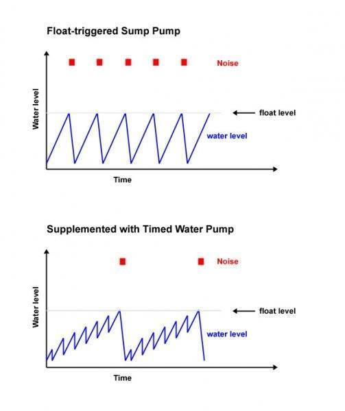

  • #31
DaveC426913 said:
There are many types. I was just showing an example of a large cartridge water pump for an aquarium.
The trick is how good the seals are. These pumps contain a large reservoir in which you are supposed to put filtering media. You don't need this, but it means the pump has a large mouth with a large O-ring seal, as well as inlets and outlets. If these will all work without leaking air, the pump can be in the air. But if not, the pump will need to be submerged, so it doesn't lose prime by leakage.
You'll have to check out the pumps to ensure the one you choose will keep a seal.
Problem with pond pumps is that they tend to need to be submerged and you won't have that luxury in your sump, since it will be drained regularly.Flexibility is proportional to cost. But the $30 timers I've used have as many as 20 programs, meaning 20 on/off cycles per day. That means it could only cycle less than once per hour. But you can set the length. So,
1] on at 12:01 off at 12:21 (7 days/week)
2] on at 1:31 off at 1:51 (7 days/week)
20] on at 11:01, off at 11:20 (7 days/week)
Or whatever.No need. With the above flexibility, you could dial the on time back by a minute at a time until your gallons per day throughput matches your needs.
Besides, the pumps have built-in flow restrictors. Better to alter the water flow than the motor revs.
But - this will still mean you're fiddling with it occasionally, because you'll never get it quite right. Especially since your inflow to the basin will change constantly with the weather.Uh, you mean on the sump pump itself? to quiet the noise? Not sure how that would work. The outlet of a sump pump is already a hose, and you can't isolate the inlet since it is integral to the pump.
You wouldn't need to do that on a water pump, as they run pretty much silently.These pumps tend to use 1/2" rubber tube. I can't imagine trying to pump water up a 1 1/2" hose. What is the weight of a column of water 12 feet tall and 1.5" in diameter? About 40lbs? But I may be misunderstanding the purpose here.

  • #32
Hi gloo. A 1/4 hp motor sump pump produces between 700 and 1000 GPH so velocity is very low, around 2 ft/s. I'm surprised the piping is making any noise, perhaps it's not related to velocity and only to some interaction with the pump. A 3/4" rubber hose is a bit small though. One thing it would do is restrict flow so that a much lower flow rate was passing out through the pipe. You don't need something that small though. I'd suggest going to a swimming pool or hardware store to find proper hose that's large enough for this.
If a lower flow rate cuts back on the noise, you might consider putting a valve in the discharge and simply close it part way to reduce flow. Sump pumps are 'dynamic' pumps with an impeller so that increasing pressure on the discharge results in reduced flow rate. You can get that affect by pinching down on a valve that's installed on the discharge. Pinch down just enough and you might get rid of the pipe noise without having to put a different pump in.

  • #36
BTW, as many have asked, we need to know flow rate.
What rate does your sump fill at? How many gallons per hour?

They operate on a 24 hour program. And 20 programs. That means, in 24 hours, you can cycle it ON/OFF 20 times. That is NOT enough to have it come on every 5 minutes, but it is enough to have it come on every 72 minutes (20 times over 24 hours).
For each of those 'ON' times, you can individually set it to turn OFF after any number of minutes.
Your 5 minutes ON / 5 minutes OFF means it's on 50% of the time. So that would translate to 36 minutes ON / 36 minutes OFF, 24/7.
It also means you have very fine control over it over 24 hours. You could set it for 35 minutes ON, 37 minutes OFF, or 25 minutes ON, 47 minutes OFF etc.

  • #51
DaveC426913 said:
He is talking about supplementing the sump with a regular pump. It is this regular pump that will run on a timer.
I know that I said that I'm out of the thread, but something strikes me about those sentences. Couldn't the sump pump (without a supplemental one) be set on the timer, but with float-switch overrides to satisfy Travis' concerns about running dry or flooding?
I'm thinking of something like a "limit switch" setup, wherein mains power has a parallel path around the timer to the float switches.
  • #52

  • #54
russ_watters said:
I don't see what value a timer would add, but whatever the case, if he gets a smaller pump it will have to run more often, not less often.
The entire idea here is to make the (noisy) sump pump turn on less often.
A supplementary pump will result in the sump filling much slower. That means the noisy sump pump will (in theory) kick in only every few hours (or even days), instead of every few minutes.
The reason for the timer is because the supplementary water pump has no feedback like the sump pump does so, if left to its own devices, it will simply drain the sump, suck air and lose prime. You set it to a direction wherein the sump is mostly drained each time, but over days, ultimately it fills up, then the sump pump kicks in and drains it rapidly.
  • #55

Thus.
Note the noise intervals. That's the goal here.
In theory, if you adjust the timer on the supplementary pump finely enough, you could stretch out that interval indefinitely - days or weeks - in theory.
(Again, I am not really advocating for this solution, just helping out the OP.)
  • #58
Say, gloo, the point of a float-triggered sump pump is that it only kicks in once the float is triggered. If you raise the float a foot or two, it will wait a lot longer until the sump is full.
Can you?
