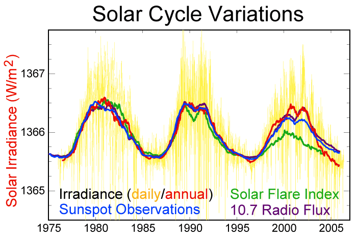

Is the radiated energy that reaches the Earth from the Sun diminishing?
Some meteorologists think it is due to the reduction of Sun spots. Is this the normal 11 year cycle, or is there more to it?
Astronomy news on Phys.org
It's not due to the sun spots directly, but to the underlying reduction in magnetic activity.
Still, the reduction is only about half a watt per square meter less than average. See below.
Could this reduction in the Suns energy have any effect on the Earths climate?
On the TV the other day, a weather man for the BBC said that we might be heading for another medieval ice age.
I'm sure it has a small effect on Earth's climate, but unless it stays below average for a prolonged period of time we will be fine.
The absolute magnitude of that scale is small. It would correspond to a direct change in the Earth's temperature of 0.2C. Furthermore, an 11 year cycle is too fast and the Earth has too much thermal inertia for this to be a big effect.
It is true that the Little Ice Age coincided with the solar Maunder Minimum. That was a ~500 year period, so the 11 year argument doesn't apply. However, it's not known if this is cause and effect: it's not known how global the Little Ice Age was, there are other candidate explanations, and even if this was due to solar activity, it might have been indirect: temperature changes due to cloud cover changes rather than direct solar forcing.
I've also heard it said that we are overdue for a real ice age, but the same logic applies: a few years near the solar minimum is far too short to trigger one.

How low would the Suns intensity have to go before it started global cooling?
Using Boltsman's radiation law, and putting in 5855 Kelvin for the Suns temperature, I get an average intensity at
the top of the Earths atmosphere of 1369.39 Watts/m^2.
This is obviously incorrect according to the graph, can someone please tell me why?
The Sun is not a perfect black body, so the emitted radiation spectrum will be slightly off. But you're only 2 watts/m2 off, still pretty close.
